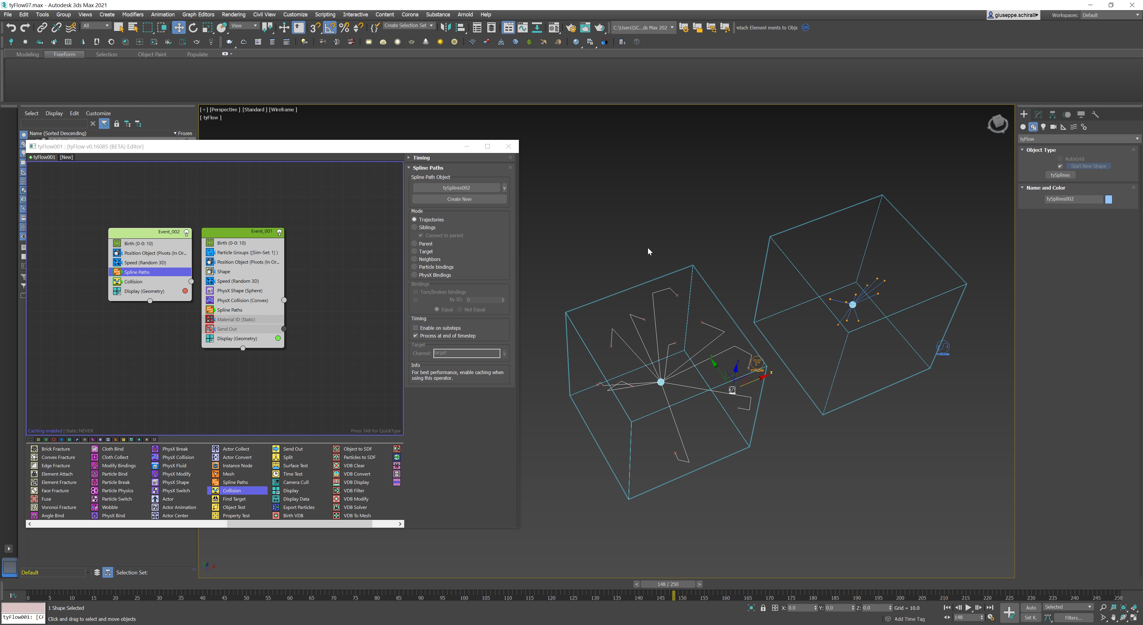

Speed Random3d with the PhysX Shape seems to be working only on 2 axis (XZ).
The same type of setup with a regular particle works on XYZ.
Attached a sample scene, refer to Event_001.
Thanks!
-Giuseppe
.max   tyFlow07.max (Size: 812 KB / Downloads: 321)
You locked the Y-axis in your PhysX Shape settings (dynamics rollout). Probably not a good idea if you want it to move in Y Smile
Oh you are right. I really can't explain why it was checked. I don't remember being playing with that setting.
Now I know!
Thanks!
