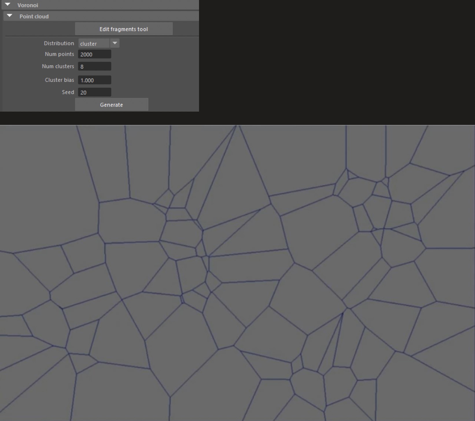

I was comparing the Voronoi fracturing between Tyflow and "FractureFX" (an old Maya tool I have, which has several advanced features for fracturing).
There is it possible to set random so-called "cluster points" (either randomly by number or by tex map), which makes it much more realistic looking.
This is procedurally imitating a natural behaviour:
Glas is not breaking uniform, there are centers like spiderwebs, which are building the voronoi fractures.
It is possible to set the number of those clusters and drive their position for example with texture map.
Please have a look, this would let fractures look more like in real life.
I have attached a screenshot here.
Interesting you say that...when I originally wrote the Voronoi operator I had that exact functionality in there, but I eventually took it out for a reason I can't remember. Maybe I should put it back in...
Anyways, for now you can recreate that effect by simply setting the operator to use a separate particle system as the point source, and then generating some particles with localized child particles like in your screenshot. I've attached an example showing how.

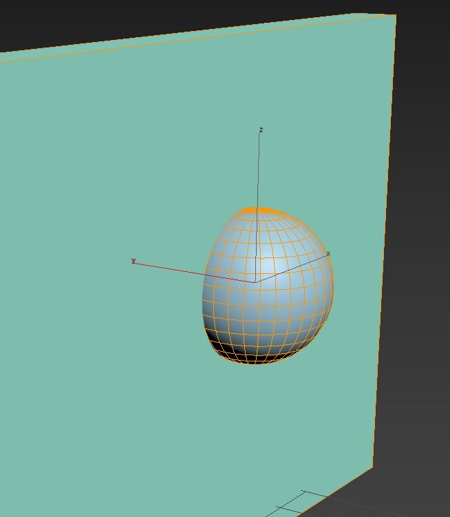

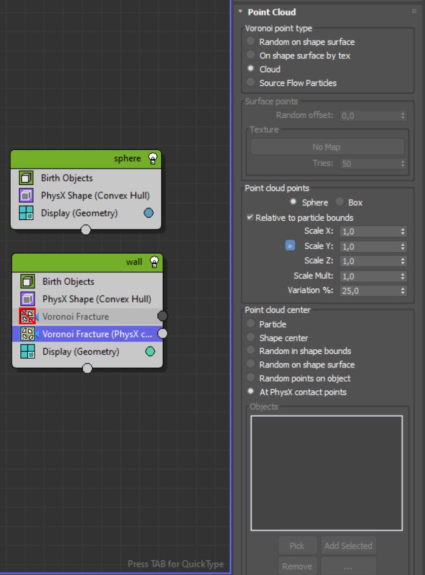

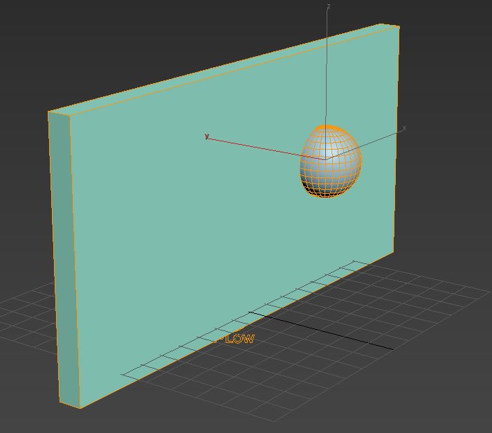

2.)  I also tested PhysX contact (which sounds promising), but did not understand, how to add there an object
(attached screenshots) Could you explain, why it's not letting me to add the sphere?
