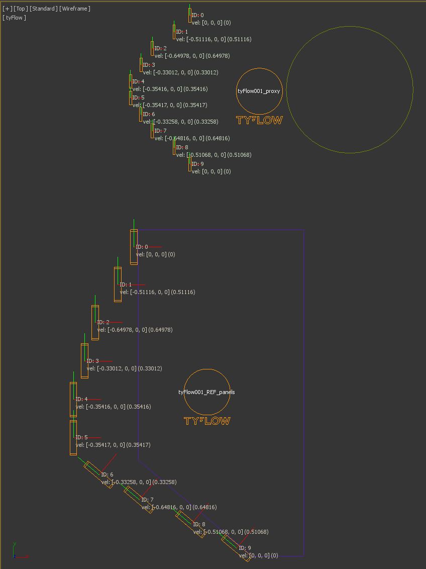

I have a row of 10 boxes (ids 0-9) set up as a proxy flow.

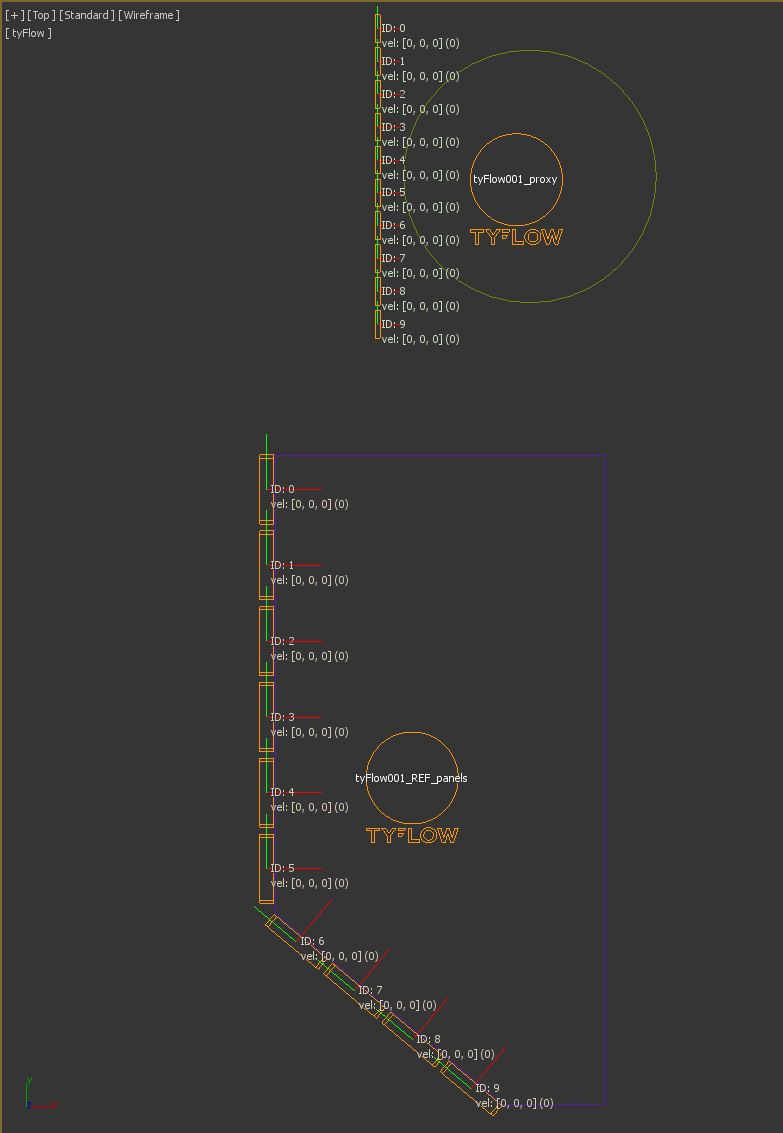

The second flow is another set of 10 objects (ids 0-9) with 4 of them rotated in plan.

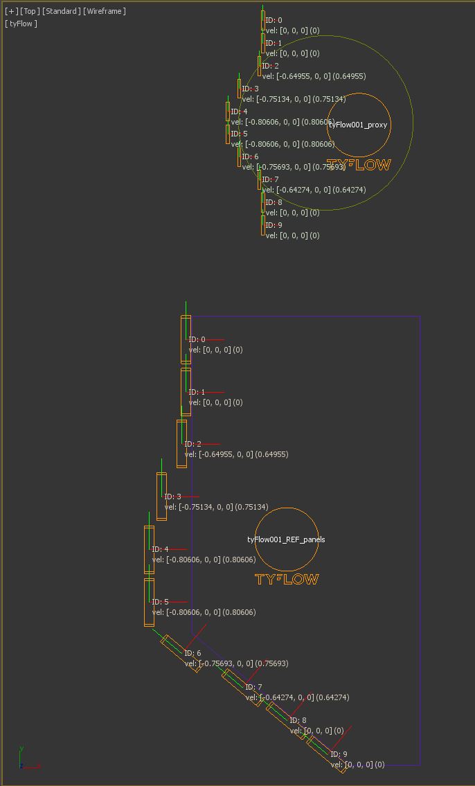

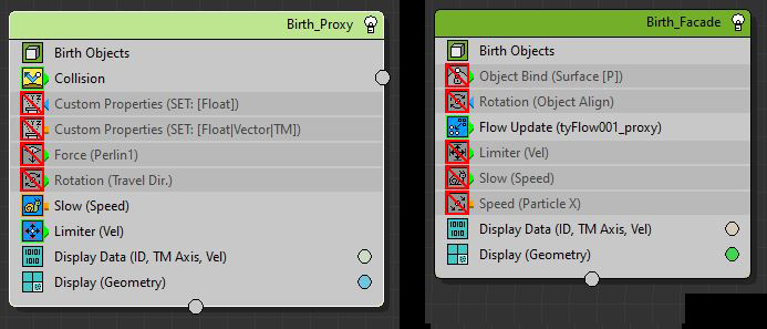

I'm hoping to use the proxy flow to drive the motion of a second flow (see attached).
The large green circle pushes the particles to the left using a Collision Op in the proxy flow.

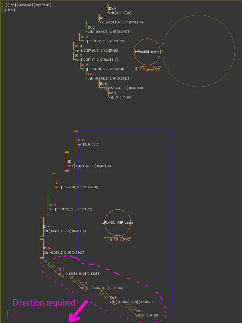

The problem I have is that the motion of the particles in the second flow moves along the X axis in world direction BUT I want them to move only along their LOCAL X axis - ie) in direction of red lines.
Essentially what Im trying to do is map the local X positions/velocites only from one flow to another.
Is there a way of getting this method to work? - or should I be looking at using Custom Properties and Targets?
Any help much appreciated
