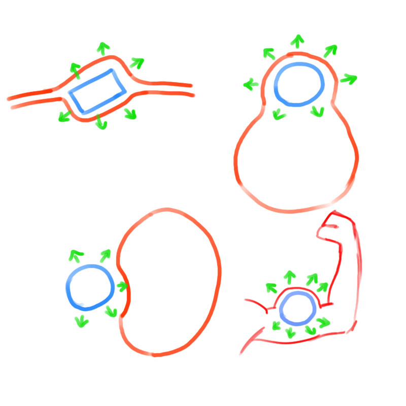

Hi, I just wanted to come with a suggestion for a modifier that I think would be amazing to improve, since you keep making awesome versions of 3DS Max's native modifiers.
I often use the push modifier with a vertex soft selection based on area to make different results like stuff moving through a elastic tube or muscles. But sadly 3ds Max's native push modifier only support pushing objects from their own normals. But if you had a Push modifier that could use select other objects normals as a push with distance and soft selection/area falloff you could use the modifier to do a lot of amazing things that in general is quite difficult to set up.
See sketch example attached Smile
Cheers
Joachim

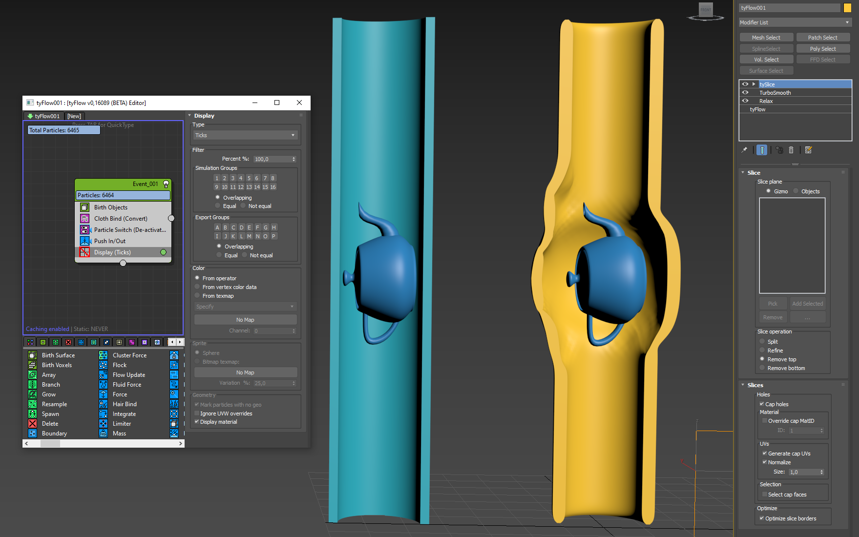

Okay sorry, the tyConform doesn't do the job. It would need some option to reverse direction to do it.
But I made a quick flow setup that almost does the job:

Hi thanks for the TyConform suggestion. Actually I tried that also, it works slightly with some objects, like a cylinder with no ends, but it breaks if you move the object slightly outside - so its a half good solution Smile it can solve some situations, but a push modifier with support of other objects could be very useful in many situations.
