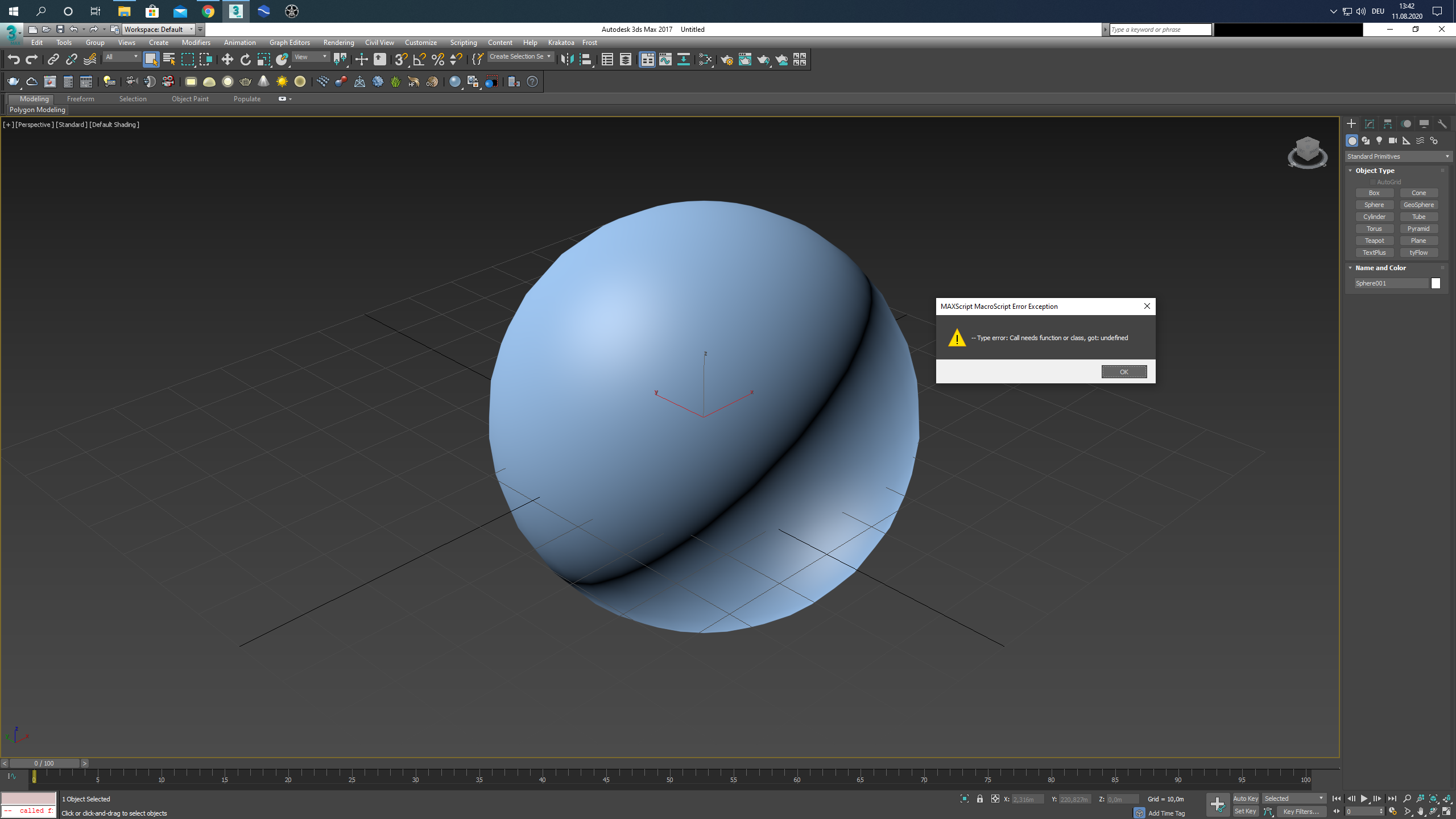

i get an Maxscript Error when i try to open the tyPreview Window. See attached file.
I always use "Tools menu -> preview - grab viewport -> create tyPreview.
When i hit "Create tyPreview" the Error prompt comes.

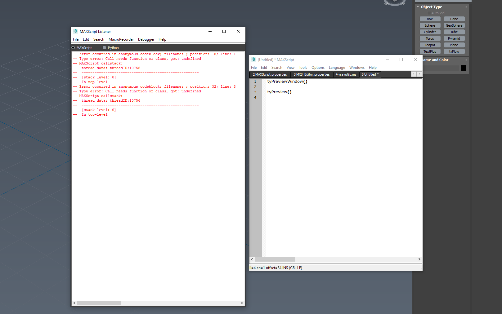

If you type tyPreview() or tyPreviewWindow() in the MAXScript listener, do you still get the error?

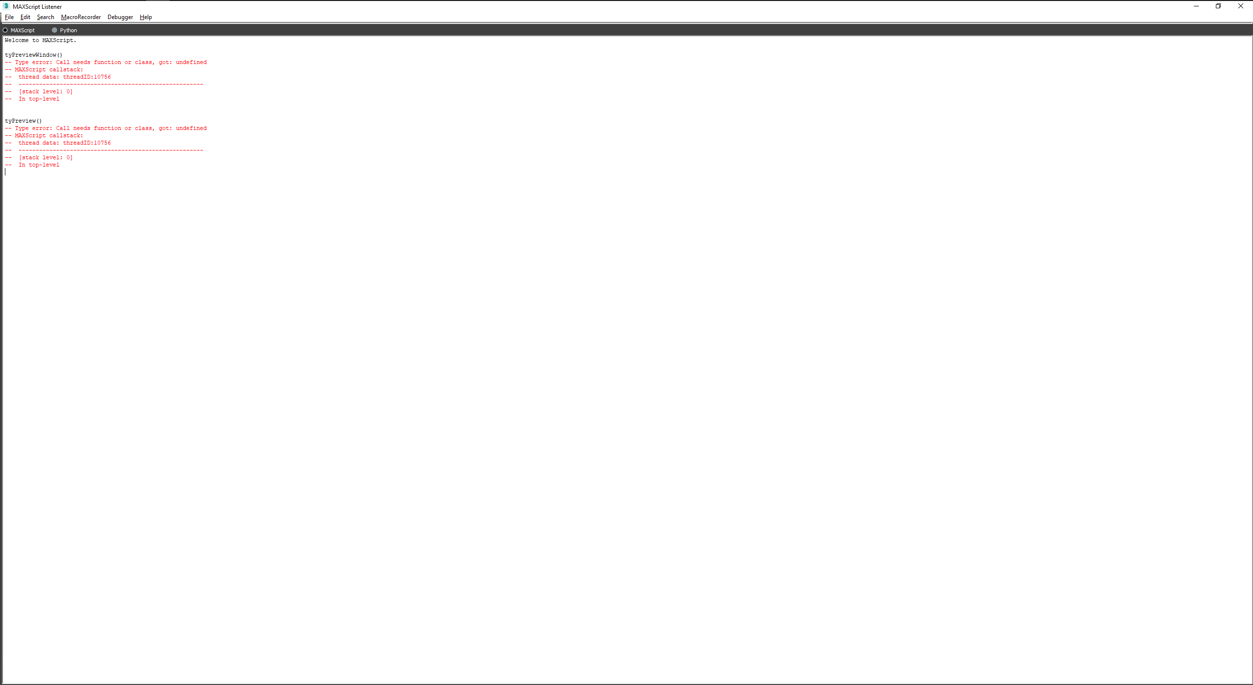

(08-11-2020, 03:00 PM)tyFlow Wrote: If you type tyPreview() or tyPreviewWindow() in the MAXScript listener, do you still get the error?
yes they both return undefined
i tried in listener window and in a new maxScript window; see attached pngs.
Can you triple check that you are using the latest build? It's very strange that the internal MAXScript bindings would just fail like that...
