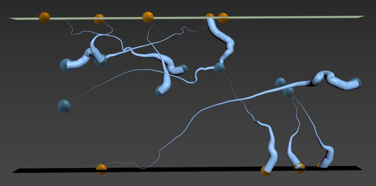

I'm working on a setup based on Nickolay Shchetinkin's great electrical arcing example he shared on the fb group a little while back.  What I'm still trying to figure out is how to get my particle binds to always be in Birth-to-Target order so the splines go one direction.  Right now it's random, with about half of them going each way.  In the Max scene I've attached I want the taper to always start at the Birth particle (yellow sprite display) and end at the Target particle (blue sprites).  Thanks in advance for any help on how to achieve this.

In your tySplines object setting, choose "weld knots" instead of "weld bindings" and make sure "sort knots" is enabled.
Eventually I should probably combine the two features since I understand deciding which one to use can be confusing. But weld + sort will keep the knots ordered by ID.
That seems to do the trick. Thanks Tyson!
