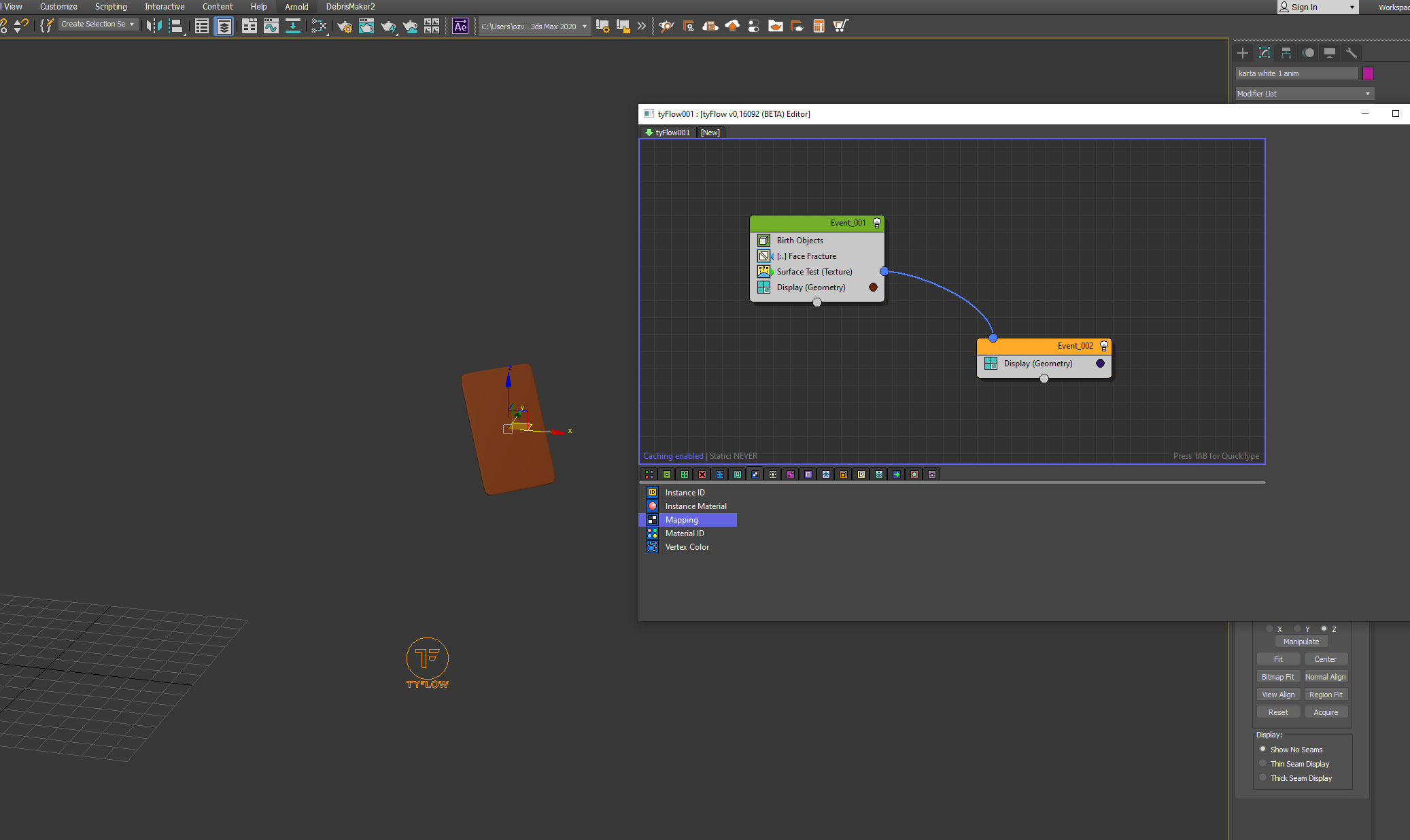

Hi, i am new to tyflow... and i am stuck...
I have animated box (position, rotation) as birth object with inherit pos. and rot. ticked on. And i added surface test texture (gradient ramp) to trigger face fracture animation... the problem is while the object is moving it seems the gradient trgiger map mapping is totaly off... when i apply same setup on static object its working fine...
it looks like its mapped to whole animation path from start position to end... if u know what i mean one big stretched texture to whole scene ... ignoring obj uv's
please help what am i missing?

i bet its something simple... the card is animated fly trough space... and i just cant figure how to stick the uvs to the card obj...

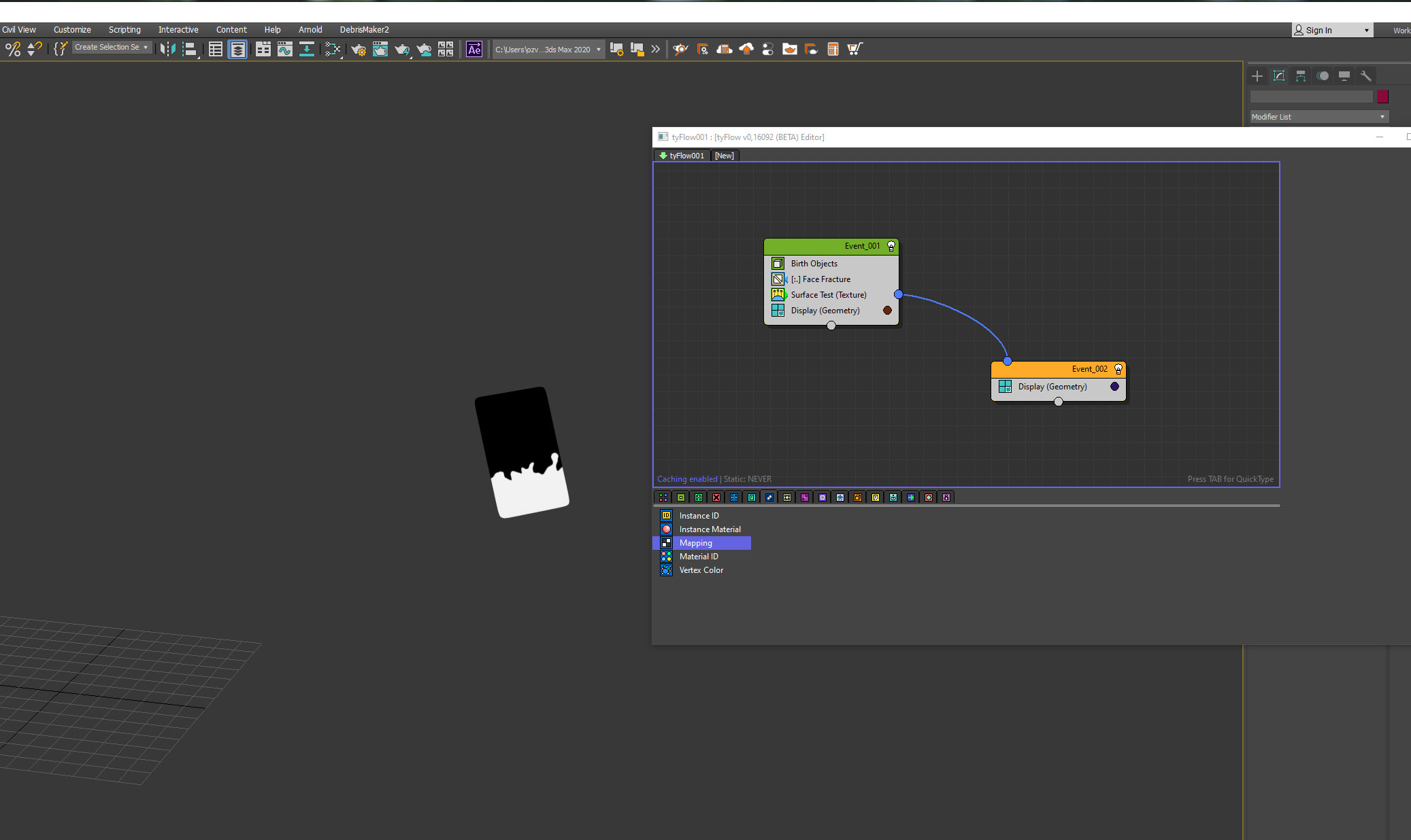

first picture is animated card with default 3ds max gradient ramp (animated) with noise
second is tyflow instance ...
when i use same setup on static geometry is working fine also the card change to another event at some point but like the uvs was somewhere else...
can you see the problem from what i posted or do you need the scene file?

Is this what you want?
.rar   Card_01.rar (Size: 35.52 KB / Downloads: 515)
so the object bind operator is the magic ingredience... thank you so much
(09-21-2020, 06:49 PM)tomas_ozvold Wrote: so the object bind operator is the magic ingredience... thank you so much
Yeah, well.
It's because you can't expect that birth object operator do the position/rotation/scale inheritance, after you broke that particle object with voronoi (you basically created many particles from only one particle).
