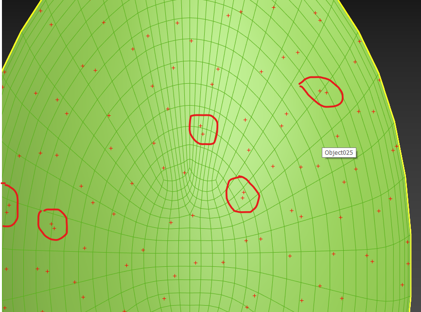

For that I used a birth, then a shape to assign a custom geometry from my scene and then a position object and picked a surface to scatter the teeth on. I was looking for an even distribution so i thought that turning on "separation" would be the way to go but it didn't worked as I expected, even after tweaking the "distance" and "tries" settings, and also the number of born particles. As you can see in the following screenshots there are some particles that are very close to one another, as if they were ignoring the "distance" value, resulting in a very uneven distribution.

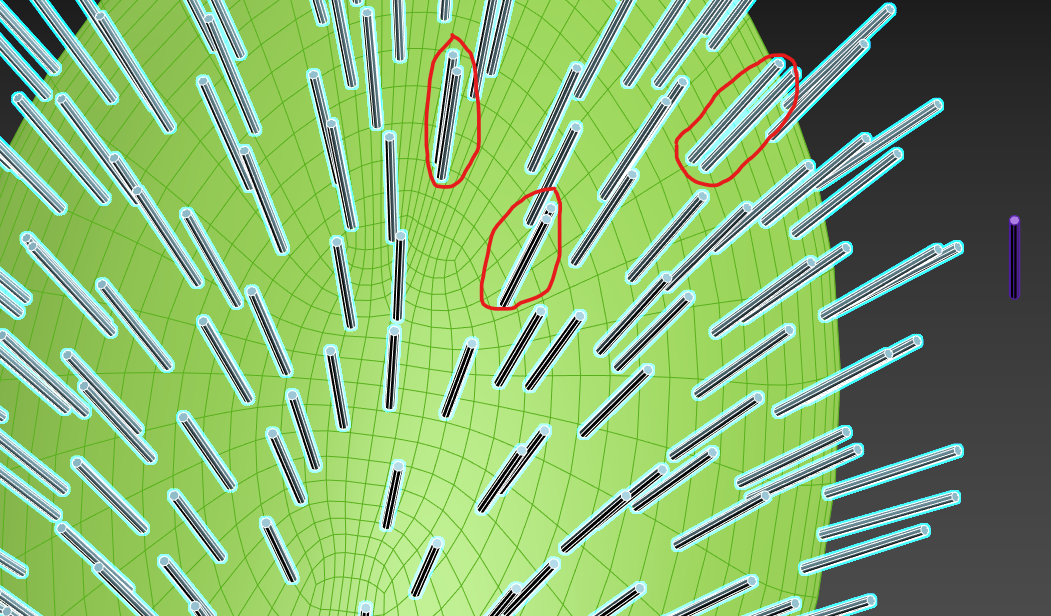

Below, same simulation with different "display" settings

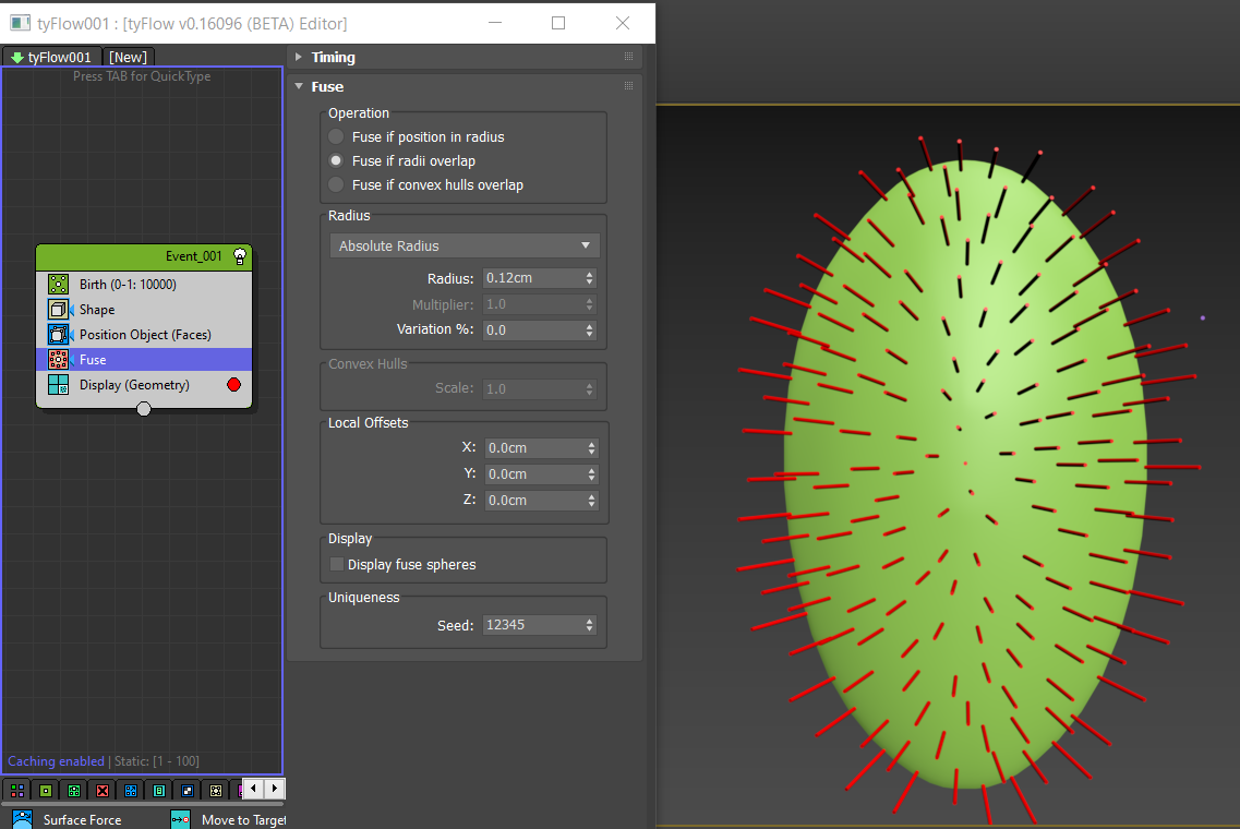

In case anyone wants to do something similar to this and is running into the same issue, a user of facebook suggested raising the number of particles and using a Fuse operator to control the teeth density. This worked perfectly.

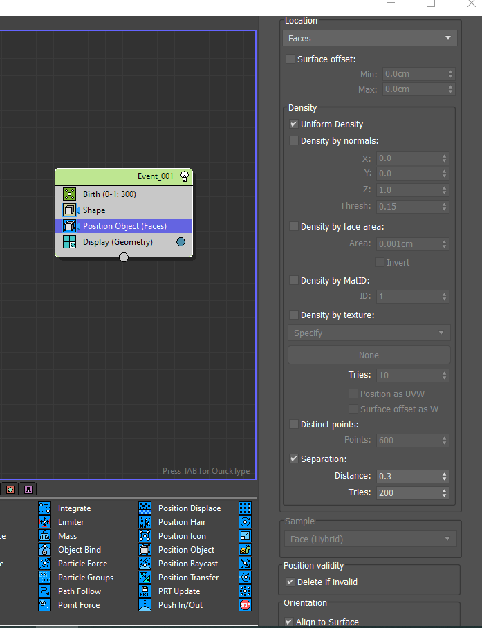

Below, EDITOR WINDOW of said simulation
