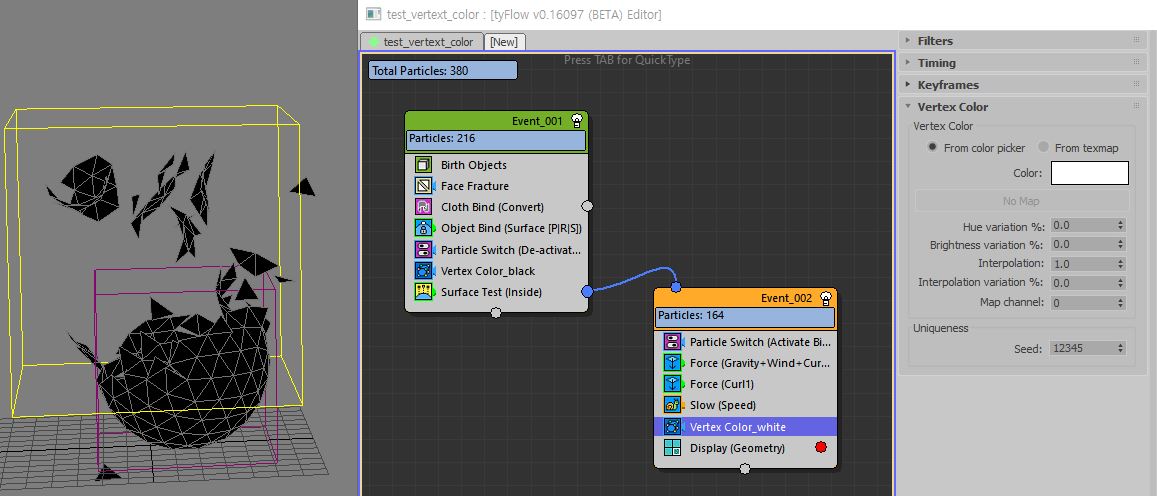

vertex color op, do not working.
vertex color operator, no more working in cloth binded shapes

Thanks, this is a regression accidentally introduced in a recent build. Will be fixed in v0.16099.

(12-19-2020, 08:20 AM)tyFlow Wrote: Thanks, this is a regression accidentally introduced in a recent build. Will be fixed in v0.16099.
Thanks for your time.
Now it works fine.
But, there is one very minor problem.
Bellow line code still does not work in cloth binded shape..
tf.SetUVW (sInx, 0, uvw);  // but other channels is working well.

Thank you for letting me know. It seems like in the Script operator specifically, I was accidentally clamping the minimum channel value to 1. That will be fixed in the next build.
