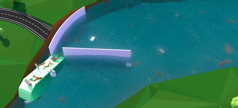

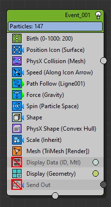

I'm still a beginner with Tyflow (and particles in general) so my question will probably sound silly. I can't understand the logic of something that seems quite simple to me.
I'm making a small river in lowpoly, and I'd like particles to be born on the right side of the water, travel the river while being half submerged while following the surface of the geometry, and die on the right side.
But I can't do it. The only thing I manage to do correctly is the collision with the rock. Not very glorious.
Could you point me in the right direction? I'm not asking you to do the work for me, just to explain the logic to me.
Thank you in advance for any help.
