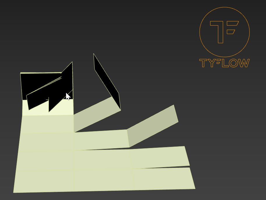

I'm testing now with animated geometry.
In this case it's just a keyframed fold animation, where each face is a single piece.
How can I import this into tyflow including its animation?
I tested several ways but did not find out.
Shape operator (animation enabled), or tyActor (deformations enabled)...

No, there's not a way to inherit visibility.
In normal circumstances, in order to inherit motion and retain cloth attributes, you could use a Particle Switch to de-activate the cloth particles and then Object Bind (surface mode) to bind them to your animated surface. However, based on your screenshot, your input mesh has coincident vertices...so I don't think that will work.
