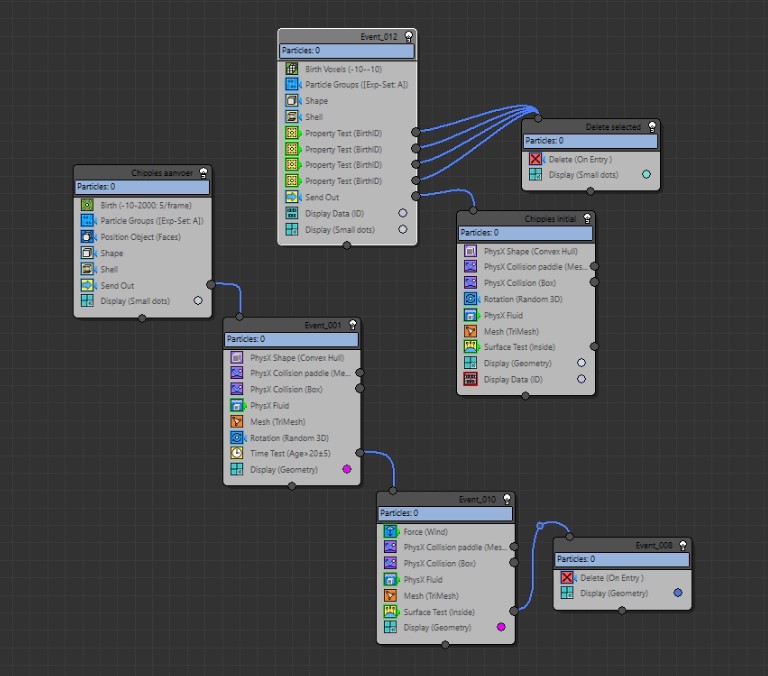

I'am working on a scene where i fill a container with phoenix liquid. In the Phoenix liquid i emit Tyflow particles and with Physx Fluid Tyflow and Phoenix work together. The Tyflow particles are floating to the surface of the Phoenix liquid and blades push them down agian. This is an ongoing proces and works fine except for one thing.
During the simulation i slowly lose my Phoenix liquid particles, until the moment the container is empty. This only happens when i simulate Phoenix + Tyflow. If i run the simulation without Tyflow the Phoenix liquid particles stay the same amount as by the start.
