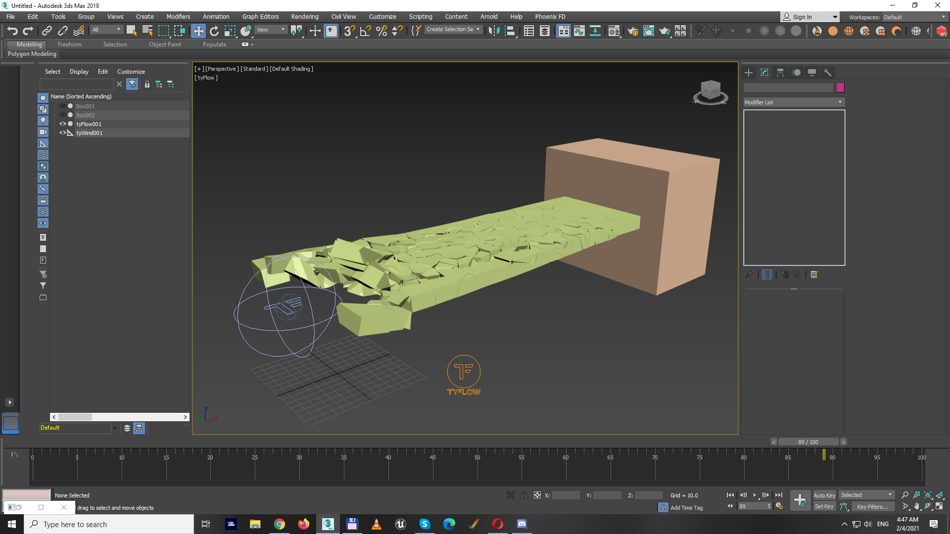

Do you want something like this (screenshot bellow)?
I did it in one event, and by using Decay on the wind force (so it gradually affect the particles (in the same event), and I added PhysX bind to particles, but with very low braking values.
There is probably couple more ways to do this, but I think they need to be in the same event , in order to gradiently affect them.

Yes exactly.
I've found that if I make an entire large object completely dynamic, and have a very small object hit into it, the entire object responds unrealistic. So I am always forced to isolate sections to get my desired results or add several test operators to fix it.
I thought it might be nice to limit the dynamic effect as the distance increases. (as it would in real life)
So yes, that's exactly what the effect I am going for.
