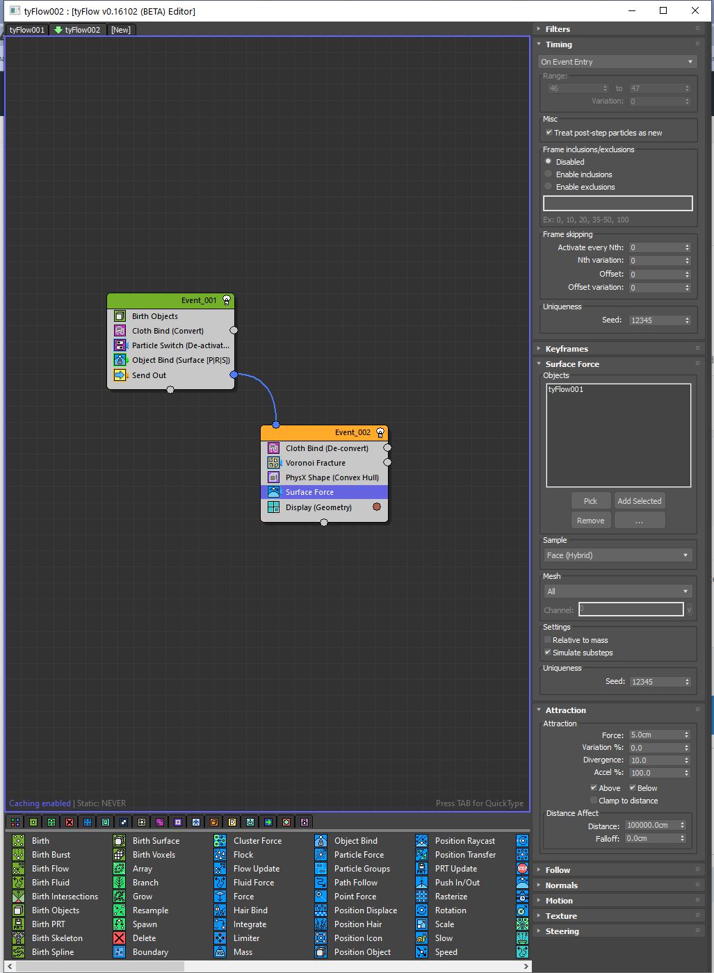

I added the surface force and told it to pick the tyflow event driving the skin. I don't see a settinf to say derive velocity froma previous flow.
I added 2 videos. 1 shoed surface force set to 1 and trhe second is to 10.
I can't tell if this is the right way to do it.

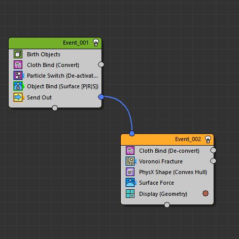

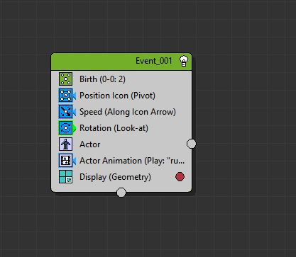

My 1st flow uses a single tyactor running animation, birthed from of 2 tyicons facing each other with Speed along the icon arrows with rotate looking at a central point so the actors face each other.
Second flow is a birth object, cloth bind, object bound to the first flow. Then I deconvert cloth bind, fracture and add physX shape.
Then all the physX fractures fall to the ground with no continuation of the direction they were going.

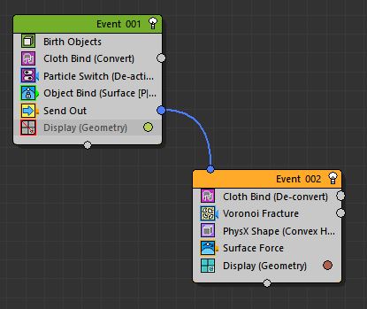

this was the other method i was trying which is simpler but still couldn't get it.

I took a look at your setup. The first file was headed in the right direction. You just forgot to adjust the Surface Force settings. The attraction value is 5 and motion is 0. You want attraction to be 0 and want motion to be at least 100%...maybe even higher like 150% to really carry forward a lot of velocity. Also disable "simulate substeps" in this case.
The Surface Force won't pass on any spin information, so it may also be a good idea to add a Spin operator in there too for some angular velocity.
