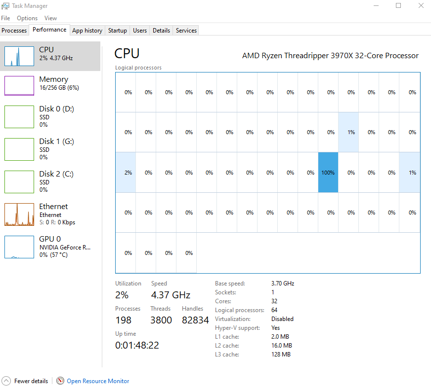

Unfortunately when opening the example scenes it is extremely slow (compared to turning CUDA off) and even worse: on some scenes it freezes MAX. So no crash, but one single CPU core stays at 100% (please see screenshot) while Max 2021 is just completely frozen.

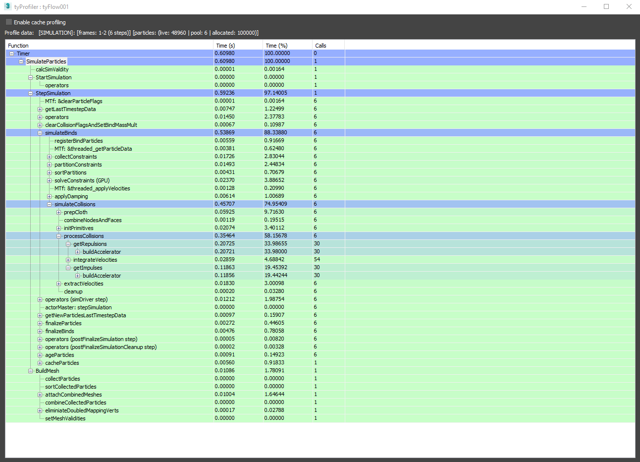

Can you open the tyProfiler from the editor right click menu (utilities), and then simulate a few frames (as many as you can before it freezes) and then expand the nodes in the tyProfiler to show where the slowdown is? (slower operations will be highlighted, allowing you to quickly determine which operations are the slowest). Then take a screenshot of which function is reported to be the slowest and post it here.

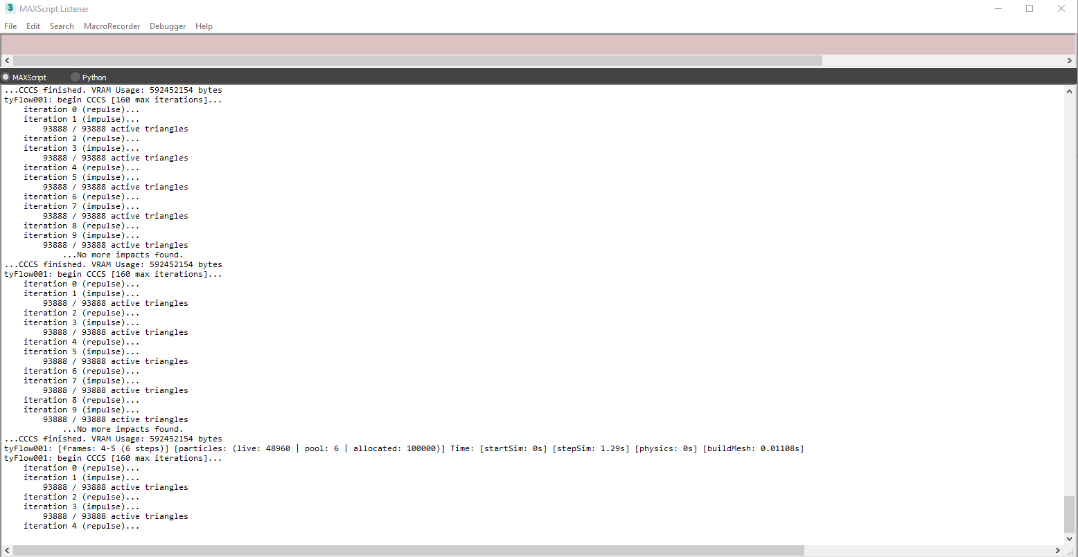

Next, can you open the Debugging rollout of the tyFlow and enable CCCS printouts. Then open the MAXScript listener and re-run the sim. It will run a lot slower, but you should see the MAXScript listener updating at least with CCCS info. Now wait until a frame where it normally would have "frozen"...is the MAXScript listener still updating with CCCS info? Or is everything completely frozen? If you don't mind, give it at least 5 minutes of non-updating MAXScript listener before concluding that it's totally frozen. Doing this part will help me determine if tyFlow is actually frozen, or if there's just an issue causing impact zones to take a really long time to solve.

Please have a look at the attached screenshots. I let the sim run for about 10minutes but nothing changed in the Listener so I had to end task again.

Thanks for the screenshot, TimJ...nothing looks out of the ordinary in the tyProfiler screenshot. However, the MAXScript screenshot shows the crash happening during repulse calculations, which is bizarre.

could you somehow manage to investigate a bit more about the CUDA issue? still having the same freeze (after latest tyflow update) when activating CUDA.  I am also wondering why this one thread of my CPU keeps staying at 100% (all others at 0%) in task manager while this happens... (see screenshot in first post)
