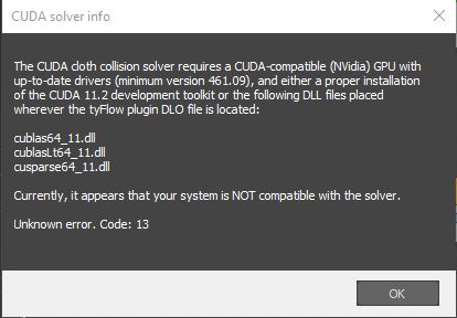

Would like to find out how to resolve this issue of error code 13 when I enable CUDA collision solver
My workstation setup:
Dual Xeon 2699v4 processors
RTX 2080TI
256GB ram
3ds MAX 2021
RTX 2080 TI: Nvidia driver 461.72 latest version
The drivers are install in C:\Program Files\Autodesk\3ds Max 2021\Plugins, where the Tyflow dlo is installed.
Any suggestion is greatly appreciated as without the CUDA collision, my cloth simply passes through the collision object.
I have also checked Compatibility Mode under GPU, closed 3ds and reopened but still with same error code
Jon

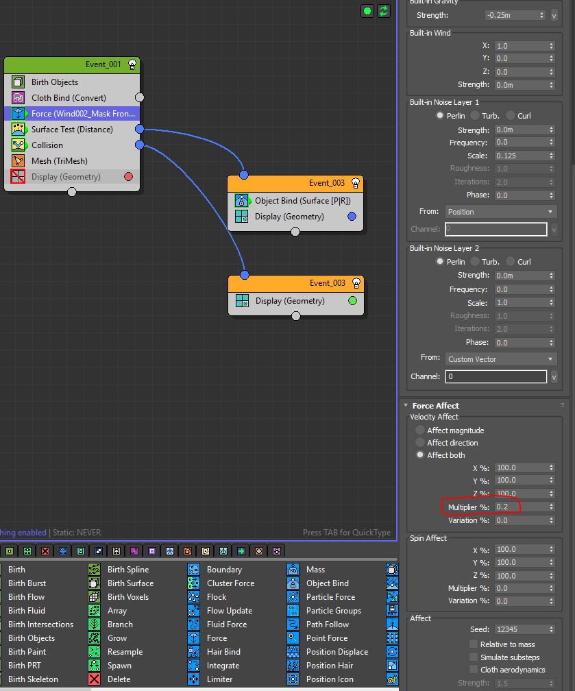

Some observations:
a.) When CUDA collision solver enabled, I am able to run up to around 38 frames of collision from my full frame length of around 1200 frames. From 39 frame onwards, the CUDA solver will crash, with error 13 and no collision happened thereafter. Have to close 3ds and reopen again
b.) Force Affect - played around with Force Effect => Velocty Affect => Affect Both => change Multiplier value to a lower value. Wahlah! CUDA solver works throughout the whole 1200 frames with no crash. Perhaps when Force is too high, it penetrate the collision object which trigger a bug within CUDA solver? Just a thought.
Although I need to finetune the cloth effect further so that it does not look too rubbery - any suggestions on this?
Frame step still using Default value of 1F
Yea what you're seeing is the IZ solver transferring over to CUDA at only a certain threshold, because up until that point it's faster to do small local collision solves on the CPU. Higher forces = more simultaneous collisions = greater chance of falling back onto CUDA.
The difficulty in debugging these issues is that they're hardware dependent....because I have systems with different GPUs/configurations that do not run into any trouble during solves. That said, I do have access to a 2080ti system and I will do further testing on it when I get a chance.
Anyways, thanks for posting your setup/info...hopefully we can track these issues down.

I'm experiencing exactly the same problem. The CUDA is correctly loaded but after some frames of calc with the most simple cloth setup, it's no longer available giving me the error code 13

I can only speak from the current setup I have as your problem sounds similar to mine:
a.) Do you have Force added with external forces? If yes, try playing around with the Multiplier value under Force to see if that helps. By changing the Multiplier value for my scene to a lower %, CUDA works with no code error 13
b.) If you want, send me your scene and I can help see if I can replicate your problem?

(03-11-2021, 01:16 PM)JonY Wrote: Quote:Frascow, you may want to see what my last post that discussed the observations and workaround I did in re to cuda crashing.
Hi JonY
I actually tested your workaround, setting the multiplier on a very low value and it works, unfortunately on the scenes I usually work the sense of scale and right physics is completely lost with this trick. Thanks for it but I really need a better solution, I'm sure Tyson will find it, meanwhile I prefer to work with the version 0.16108 that I keep running on 3dsmax 2020

I actually tested your workaround, setting the multiplier on a very low value and it works, unfortunately on the scenes I usually work the sense of scale and right physics is completely lost with this trick. Thanks for it but I really need a better solution, I'm sure Tyson will find it, meanwhile I prefer to work with the version 0.16108 that I keep running on 3dsmax 2020 I have fine tuned the physics parameters so that I can get something near to what I was expecting, this workaround works for me at the moment  So ain't complaining for this
Tried again with the latest build of TyFlow, setting all values to default. Same issue/problem again.
Had also tried 0.16108 as frascow suggested, it seems to be working still for 2021.
