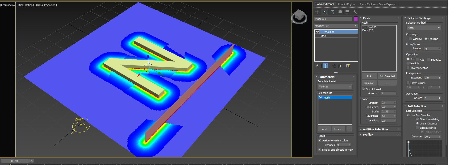

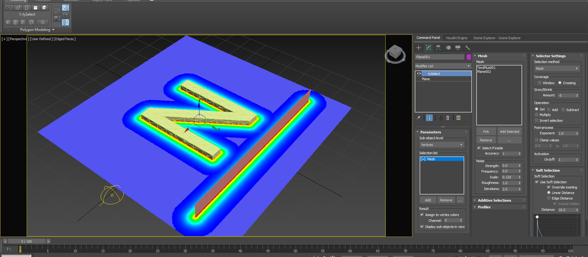

Seem Like an issue, Soft selection in tyselect doesnt work properly if the selected mesh selection object dont have any inner faces or subdivision.
Please look into it
attaching the images with issue and without issue
''Thank you

Hi Nayan,
These look like artifacts caused by the Hybrid acceleration mode, which is the default mode for the tySelect modifier. I will add a dropdown which allows the user to select the more accurate mode.
