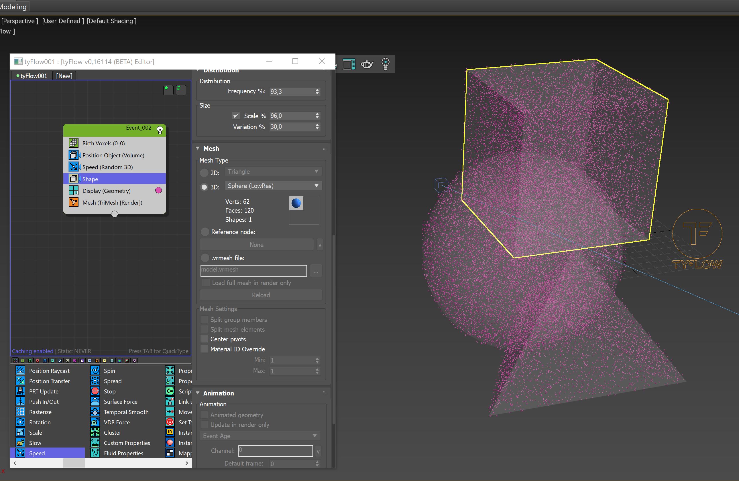

Hey there,
I would like to move particles inside their "birth voxel objects" - they should just move around without leaving the boundaries of their birth-objects.
With Speed -they ignore the objects....
thanks a lot !
.max   scene_02.max (Size: 840 KB / Downloads: 486)
Just add collision operator and pick your inital objects, and particles will collide with them.
Wink
(04-08-2021, 11:06 AM)d4rk3lf Wrote: Just add collision operator and pick your inital objects, and particles will collide with them.
Thanks a lot. Works great!
