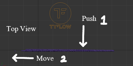

i'm not sure i'm clear. I'm attaching a diagram. two stages - 1: floating, 2: pushed through pipe.

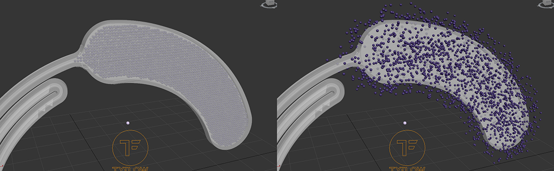

I'm still in the first part of the simulation and having a few problems. I used the Birth Voxels in order to fill the container. added shape, PhysX Shape, PhysX Collision (mesh) and then add the force (turbulence set to very low) and slow. it is a closed container but the particles "run away" from it. I'm left with little particles, when I need them all, because I will have to push them in a tunnel. I also don't get the floating effect. The container is very narrow and at parts should only contain 1 particle in depth, and it is also a in a very small size. What am I doing wrong?
Can you share some screenshot so we better understand the scene?
Or anything that will help visually describing?
here are two screenshots. 1 is the particles in the container and one when the run away.
I tried turbulence but i couldn't get to find the right setting for it to look good. it looks like a wave and disappears.

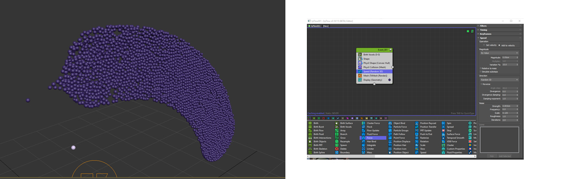

oh. I think I have made progress! look: (first attachment). I used speed. i want to have like a humming bees effect. make the particles move around themselves. I need to make sure they wont enter one another but have some bouncing look.
The next stage needs to simulate a push from the back side and the particles moving into that tunnel. (second attachment).
their surrounding is liquid, but it might as well be solid (unless it could make my life easier...)
Huh..
They are way more dense then I expected... not sure how you expect them to flow around, where they are basically touching between themselves.
It's hard to give precise advice (at least, for me), on this, unless I try scene myself.
But I'd try to push them towards that small entrance, and there I'd test them with some surface test operator, to bring them in new event, and in the new event, I'd make path follow, and they would follow a line (I previously created), in the tube.
