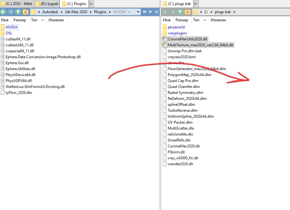

___ Anyway, I renamed ENU dir and also moved away some plugins from max dir. Here is the list of plugins that was installed: And still no luck, the issue is still here. Max is pretty clean now, and there are almost no plugins as you can see. Here is how the issue looks like: https://vimeo.com/549637080 Btw my max 2021 is fine too. I have 16, 18, 19, 20, 21, 22... I can test this issue everywhere if you wish, but I don't think this could help you

That's very strange....do the two lines of code you posted always fix the issue for you in all cases? Perhaps I will just call them behind the scenes myself to fix the issue on your side, even though I can't reproduce it. Not a great solution, but at least the problem wouldn't persist...
