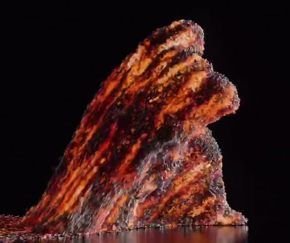

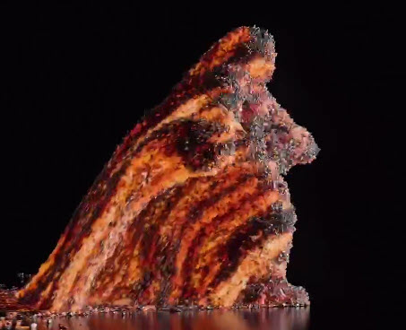

Hello, I created the walking man but the textures still has problem need to solve.
Here is the sample video:
https://drive.google.com/file/d/1s7P9Zv3...sp=sharing
And here is my work:
https://drive.google.com/file/d/1cSyCQXH...sp=sharing
As you can see, in my work there still only long self-illumination line in the body, but I need short lava animation in body like the sample video. After tested some days, I can't find a way to solve this problem.
Could you help me? Thanks.
Hi, tyflow, any help ?
Timing setting of operators are very important, set them to continuous if the data should be changed every frame(eg. cooling = temperature decreasing over time).
