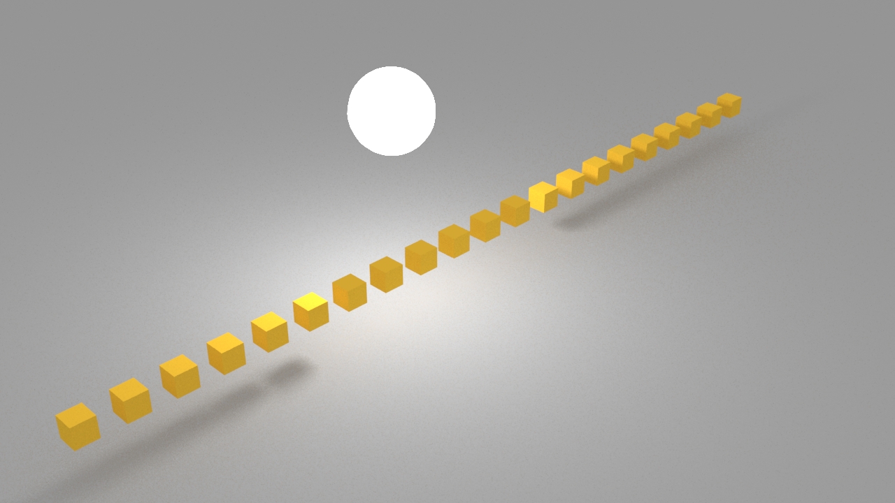

I think it's more of vray limitation, then Tyflow.
If Vray, for example, supported excluding lights from objects that have certain mat ID, then it would be very easy.
The only thing I can think of is filtering all the events (with particle groups), and just creating simple reference flow.
Where your Tyflow 02 /that is referencing certain Tyflow 01 events) is just excluded from the light.
You just make sure that in Tyflow 01, for that exact same events, you don't have mesh operator (so they are not renderable).
Maybe someone will have much better idea.
Attaching a simple file.
