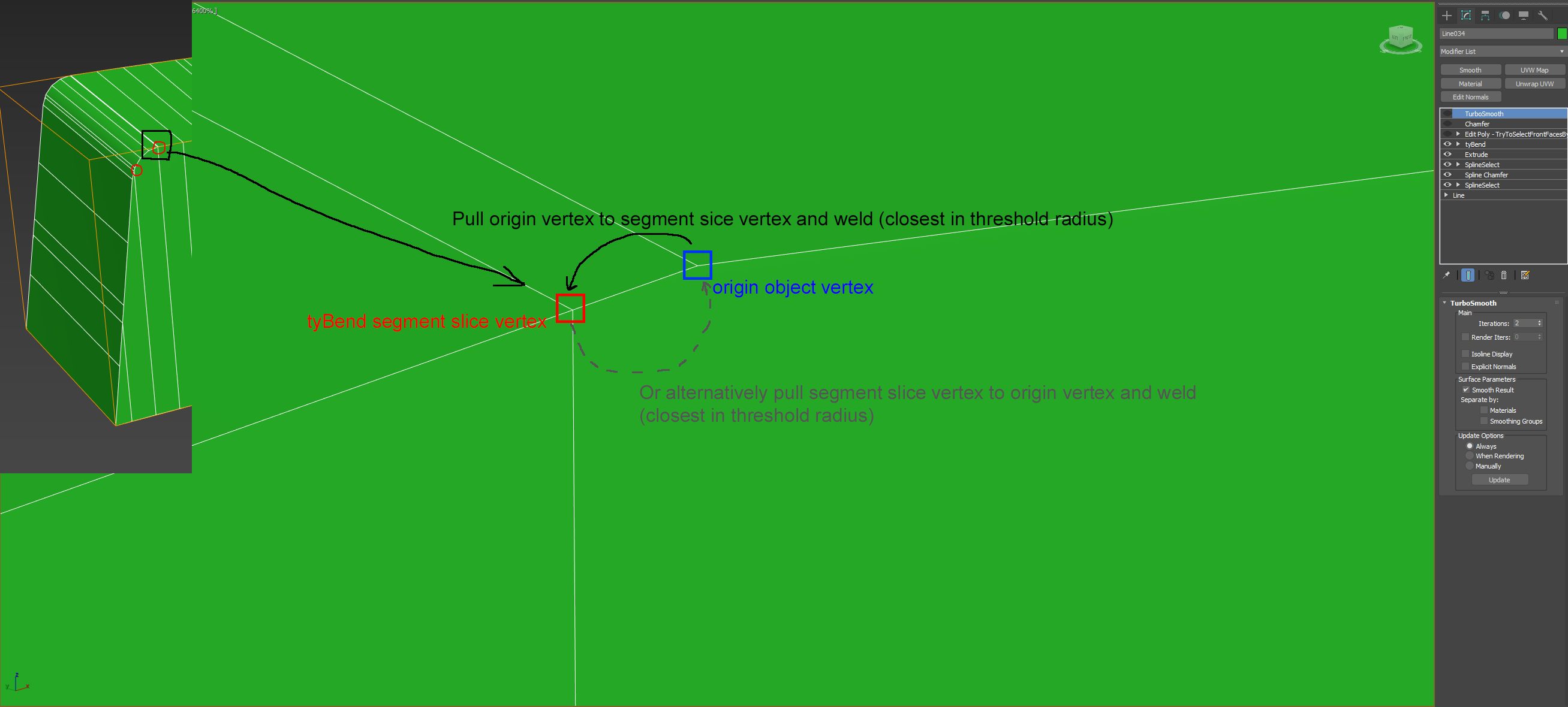

It would be great if tyBend could have a threshold (radius arround vertex) which allows welding of existing vertices with the closest vertices created by the segmentation slices. Options could be that vertices whithin the threshold should be pulled to the segement slice vertex position, to the position of the original vertices or to the center inbetween.
Important is that it only welds existing vertices with vertices that are resulting from segmentation slices. Not existing vertices with existing vertices.

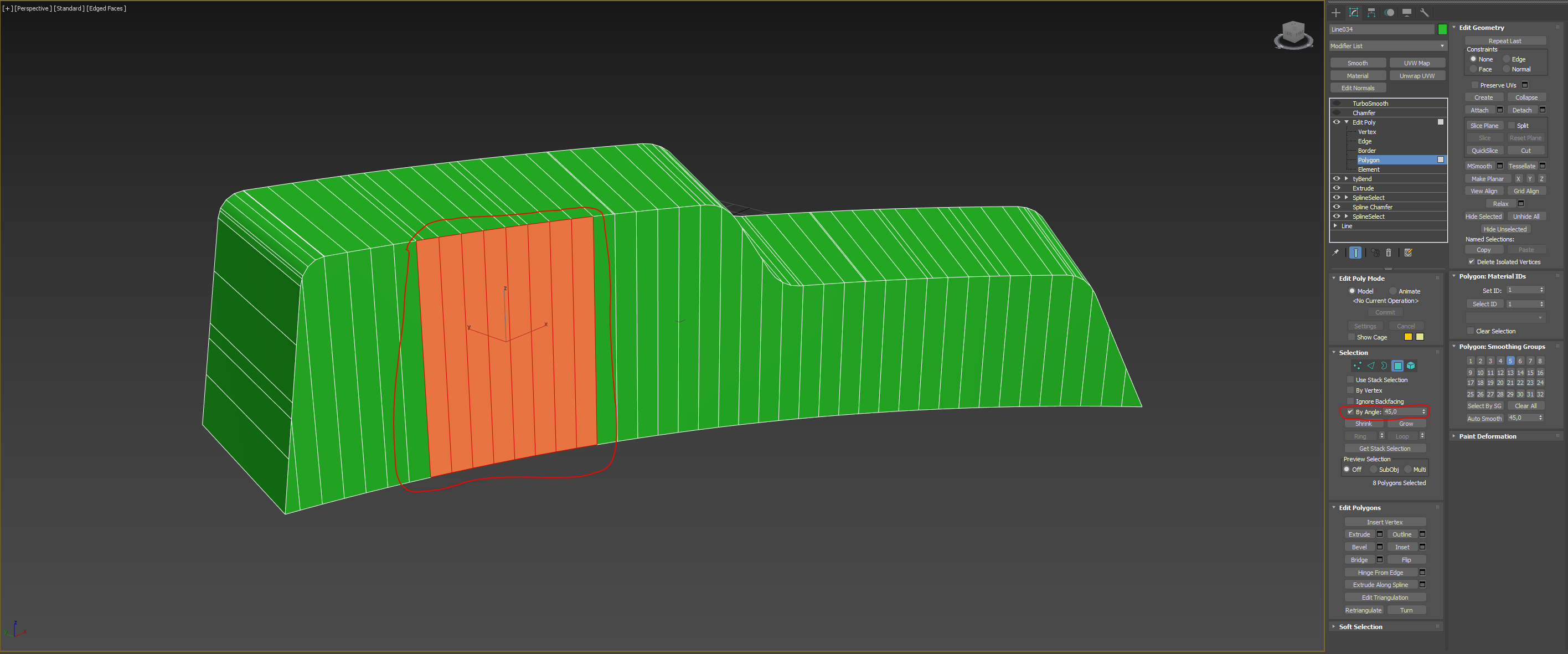

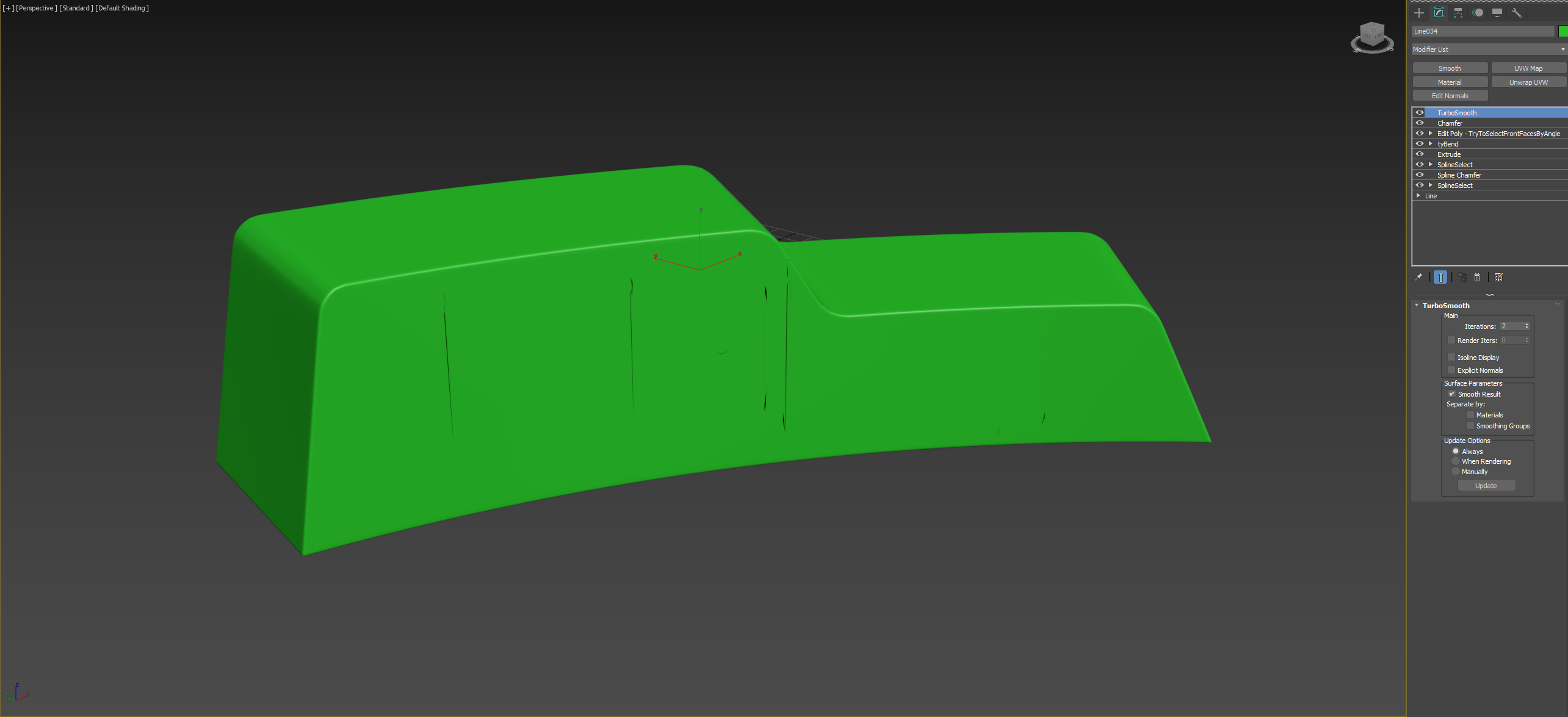

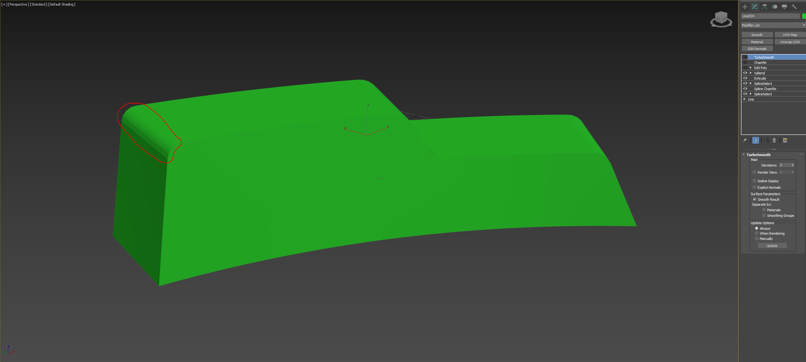

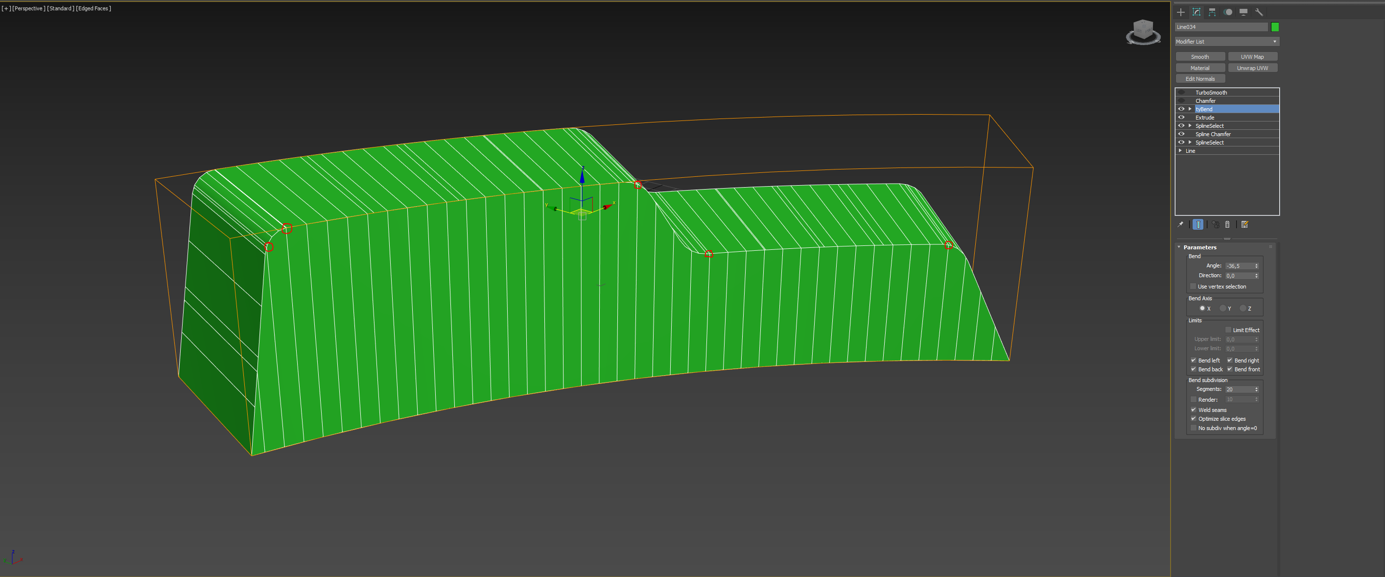

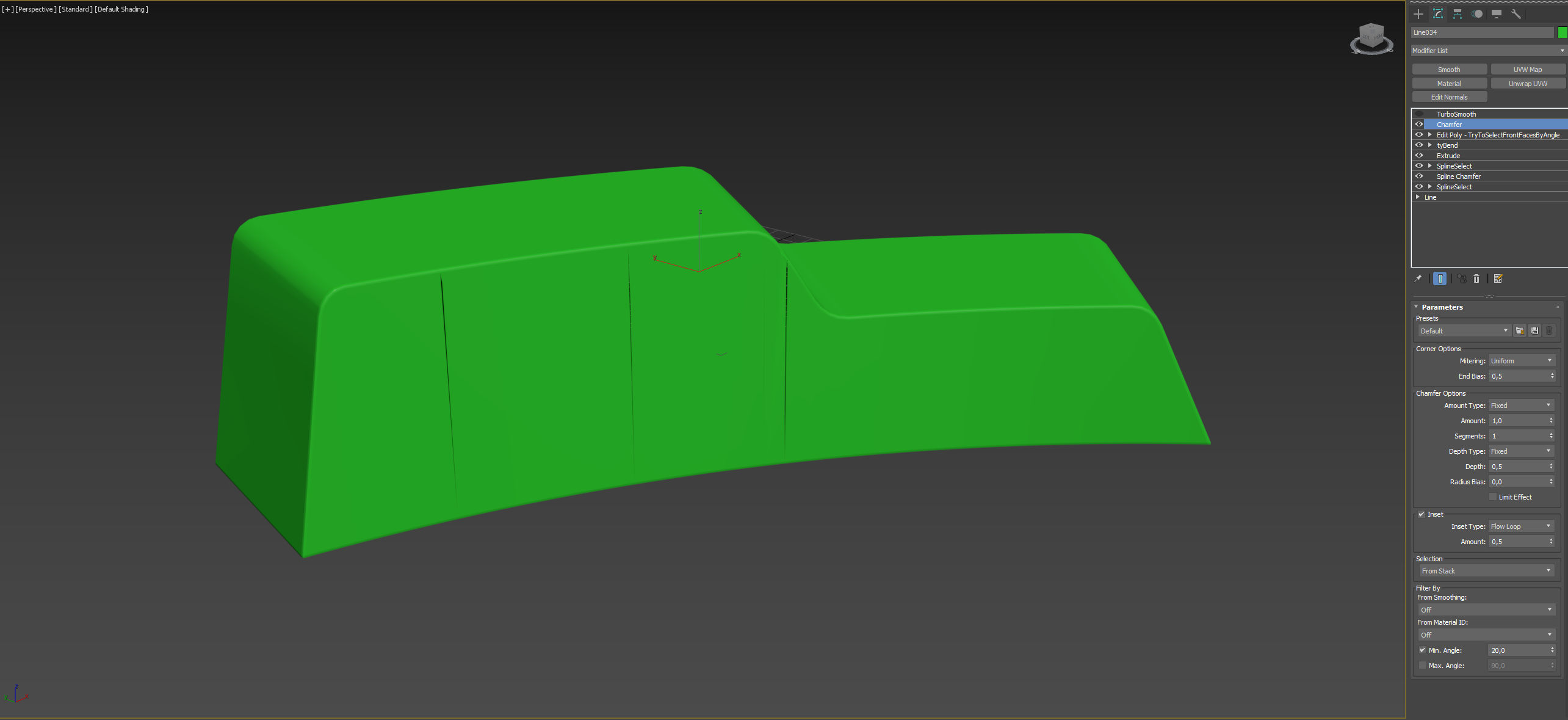

With the special welding behaviour I requested in the initial post some of the following problems can be avoided / fixed. Please see the screenshots and the maxfile attached. Thank you. The filenames of the screenshots describe the issue.

Alright, I took a look at your file and there are a few issues at play here. Firstly, the 45 degree angle selection, the black chamfer artifacts, etc, can be fixed by disabling "optimize slice edges" in the tyBend modifier. That will preserve all slice geo without trying to minimize internal faces. The minimization algorithm is what's preventing those internal faces from welding together properly post-cut, and creating the artifacts.
As for the first couple images, your model is a very specific case whose solution can't really be generalized in the way you're requesting. On most models, welding within some threshold to the slice plane would create all kinds of other artifacts. It just happens to seem like a good solution here because your model is perfectly flat along one axis. So the work required to implementing a special welding algorithm for a single type of model doesn't really make sense. I think a better solution here is just to further subdivide your model prior to bending.

I illustrated my suggstion for you for maybe better understanding.
