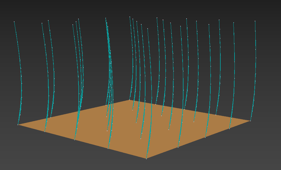

binding issue
is there a way to bind these properly?
.max   binding01.max (Size: 720 KB / Downloads: 570)
Not so that they will stand upright, since tyFlow particle bindings are orientation-agnostic.
However, you can convert the particles into PhysX shapes and bind by sibling, since PhysX can maintain rigid bindings like that with a problem.
