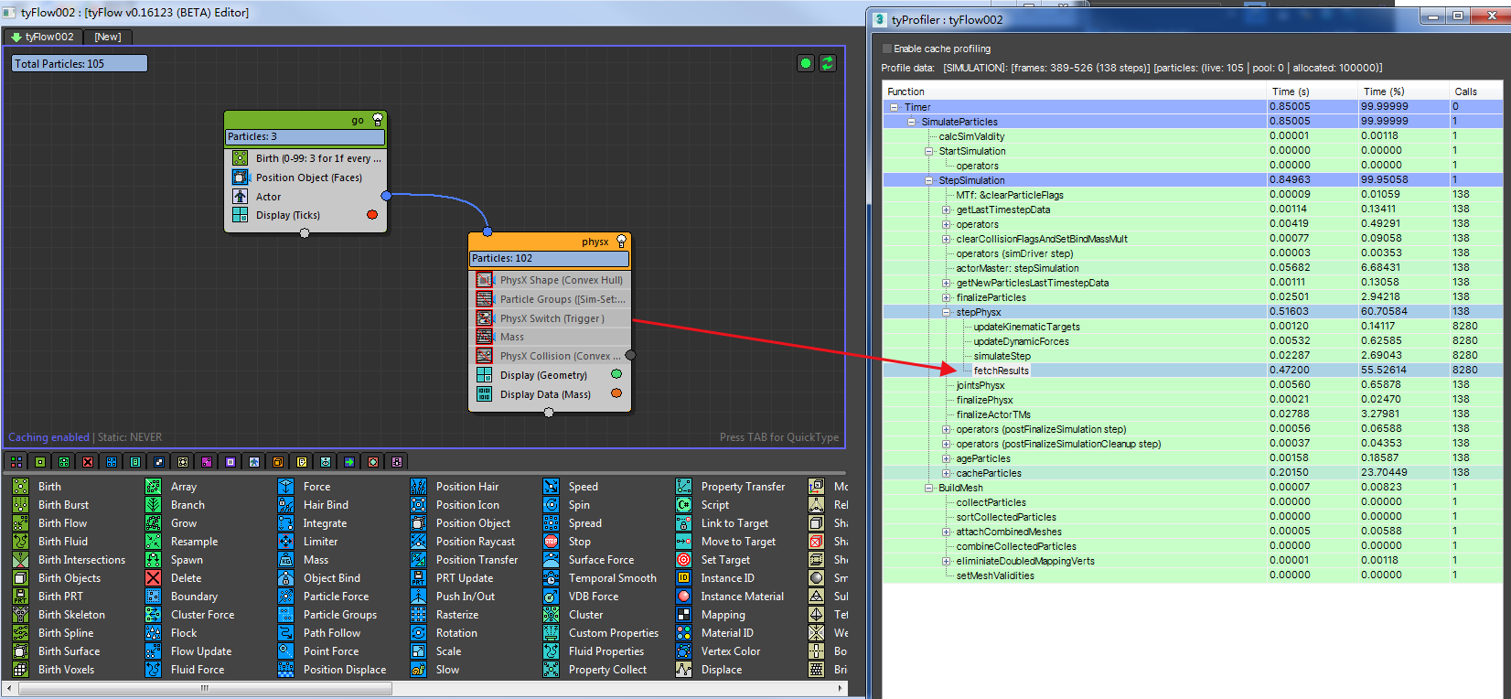

I found that after turning off all physx operators, it still consumes a lot of time on physx. This is especially obvious in larger scenarios. I made a simple scenario example.

07-14-2021, 04:48 AM
Thanks for letting me know, this will be fixed in the next build.
