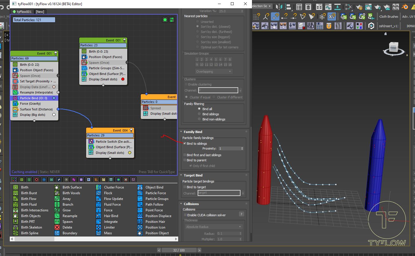

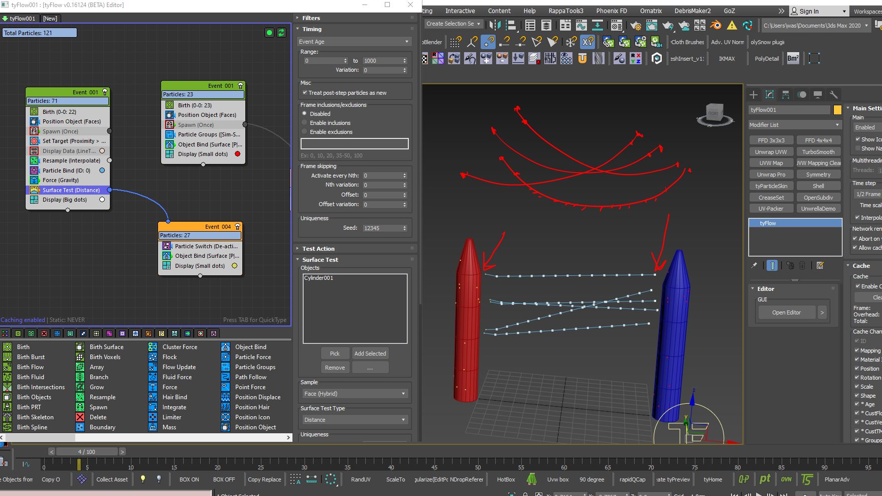

set target & particle bind not working
Hi
I'm trying to make spline between two objects by set target and hang them
how to make it work with the new logic connection between siblings
thanks
.max   set target 2020.max (Size: 708 KB / Downloads: 288)

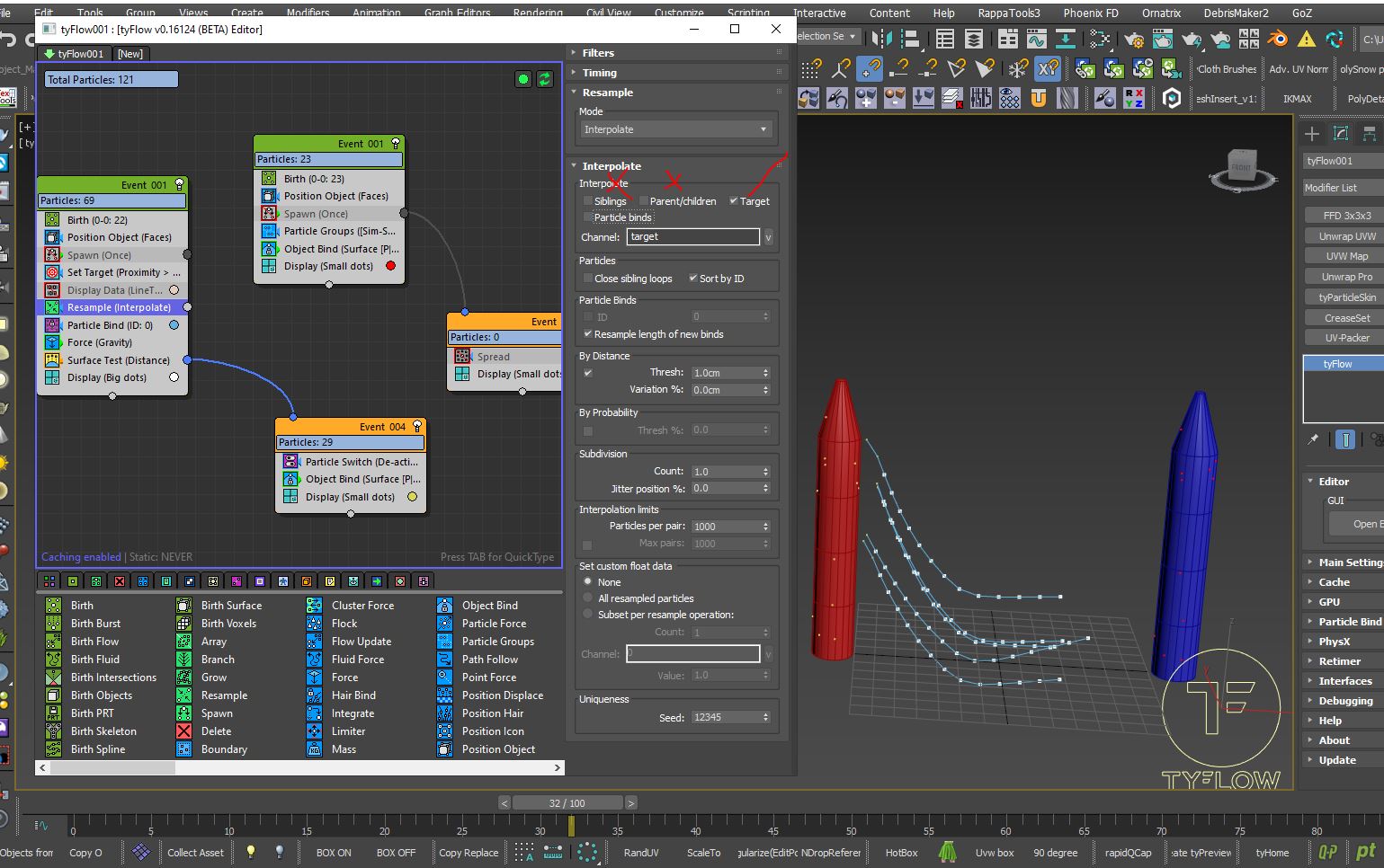

Set your binds-by-sibling (or parent/child) first, and then Resample by bind. Essentially the opposite of what you're currently doing.
(07-19-2021, 04:19 AM)tyFlow Wrote: Set your binds-by-sibling (or parent/child) first, and then Resample by bind. Essentially the opposite of what you're currently doing.
ok ?? i try but it didnt work
in resample siblings and parent not working
and in particle bind i set to sibling
hope some one see my file to understand what i mean
