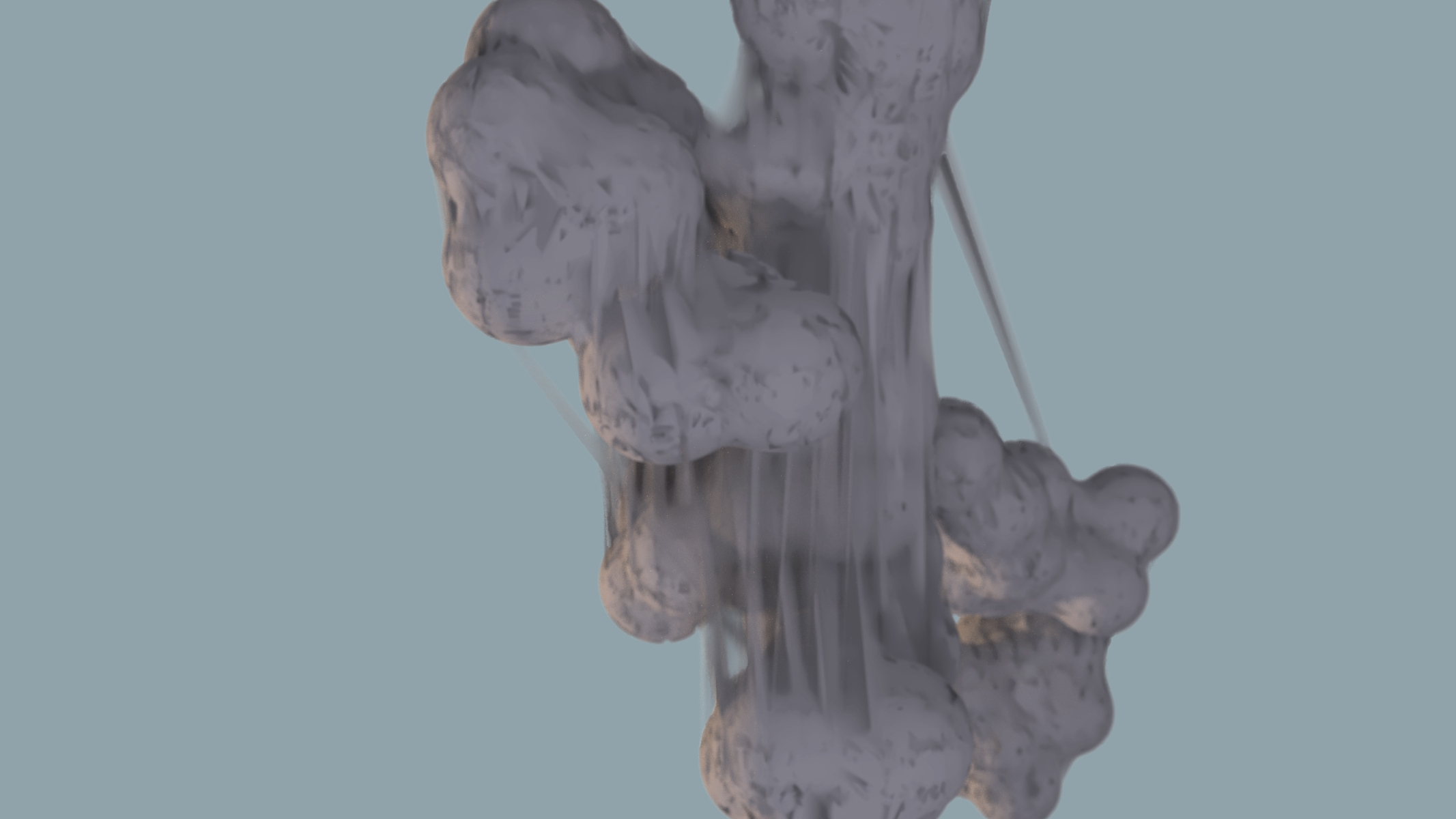

I did a test with Tymesher https://youtu.be/ZZdXoy2AOtY?t=11
some of the frames are problematic, when re-rendering sometimes they are fine.
Vray motion blur doesn't work on these frames because of the topology change
BTW I'm using retimer in the tycache
Also, it could be nice to have more control over the stickiness like a chewing-gum
Thank you have a wonderful weekend
Emmanuel
This looks like it's just VRay incorrectly interpolating moblur between frames where the total number of vertices happens to be equivalent, even though there's no cross-frame coherence between the verts. The solution is to either disable motion blur entirely or just on the deforming object.
