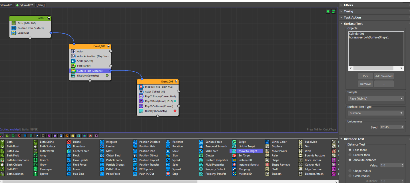

I would like to make a crowd run towards a moving target, and then get hit and turn into ragdolls.
The problems that I have are:
1. How can I make the crowd run toward the target and then follow it? currently I used a Find Target. Some actors run pass the target and then start moving backwards. I know it must be a more advanced setup to do this, and I can't think of a way with my limited knowledge.
2. the actors break up into pieces when hit even though I used actor collect and physX bind
Can someone help me get on the right track for this animation?
