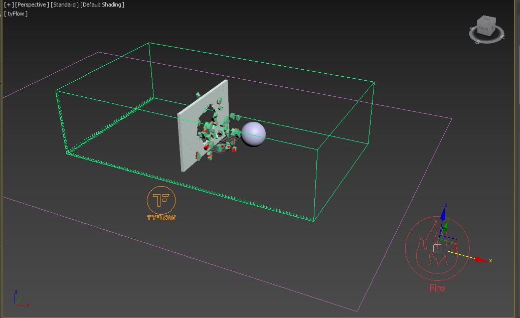

I wanted to dig deeper into TyFlow and combine it with PhoenixFD, but before i waste time on things that are not possible (yet?) and maybe someone else already tried (couldnt find anything about the following topics with the search function), i wanted to ask if it is possible to:
-let objects float on a Phoenix FD Liquid surface?
-tear cloth apart by the weigth of water?
-push objects around by water?
-let particles rise with heat of a Phoenix FD Fire? This one seems to work: https://youtu.be/bU-fC7ONfp0
Thanks in advance!

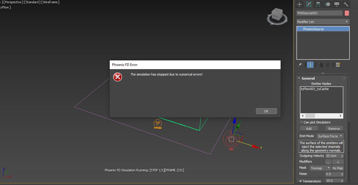

Hola, primero que nada. Gracias por su excelente complemento, al usar solo el tyCache (fragmentos) para simular humo con PhoenixFD me da este error: ¡la simulación se detuvo debido a errores numéricos! Por favor ayuda, gracias de nuevo. (Su escene muy simple para prueba.)
Jesús.
