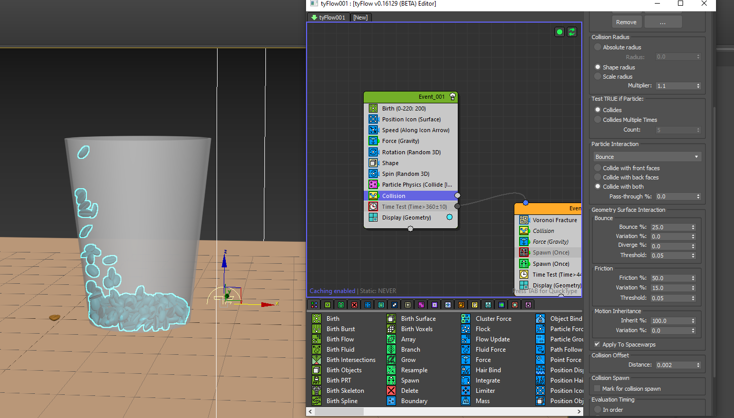

I was following along with a tut(https://youtu.be/X2vChIWG_fU) , with a few changes to it, and  getting a problem where some of my particles at the start of the flow collide and stick to the side of my cup and slowly slide down instead of bouncing off the couple down to the bottom. I'm on latest tyflow and Max 2022.2. Tried everything I could think of, created the flow again, same thing happened.

That's quite a strange result and to be honest I'm not sure why it's happening...I'd have to dive in a bit further and I will put it on my todo list...however, the fix/workaround is simple: in your collision operator, set the bounce threshold to 0.
Thanks! Glad it wasn't just me. Glad to have a good workaround!
