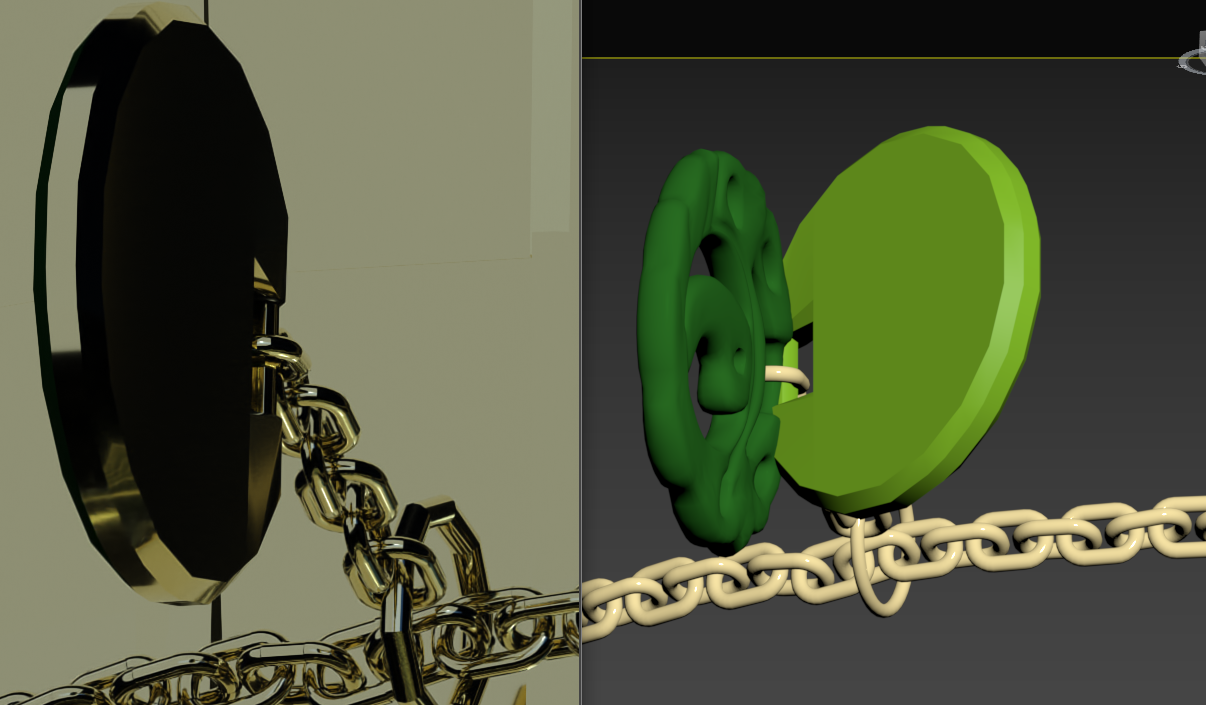

Hello have an issue here with the actor not rendering, but only the objects loaded in the skin modifier as the physx collision shapes.
Im simulating a chain with a pendant and in viewport its showing the correct objects and not the collision shapes
Right is the collision shape loaded hull type as convex with 4 parts. Left the actual actor-object.
Same issue with the torus object in the back.
There is also another collider in the back, that shouldnt be rendering, too.
How to solve this?

I've looked at your file now...this seems to be an Arnold bug. It's not querying tyFlow particles with the proper interface flag so tyFlow is returning all particles regardless of whether or not they're supposed to be renderable. Because Arnold is forcibly retrieving the wrong interface from the tyFlow object, you can't even use a trick like putting a mesh modifier on top of the tyFlow in order to override its particles and convert it to an editable mesh for rendering.
Luckily there is a simple workaround in your case:
Create a tyMesher object, set mode to "Input Geometry", disable "force particle interface" and then select your tyFlow object. The tyFlow will pass only its actor meshes to the tyMesher, and Arnold won't override the tyMesher output with the particle data.
For what it's worth, I've logged the bugs with Autodesk's bug tracker. Hopefully they can fix the Arnold issues.

Thank you, that worked well.
