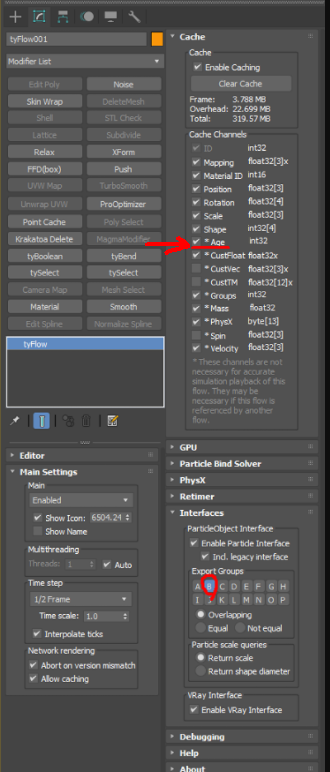

The breakdown of the flow is as follows. (Images are attached.)

Have you enabled age caching in your flow?
(10-06-2021, 06:41 AM)tyFlow Wrote: Have you enabled age caching in your flow?
Yes, as you can see in the image, the cache of Age is enabled.

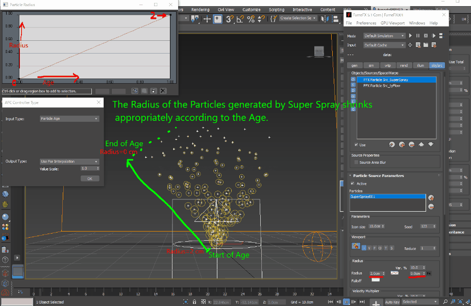

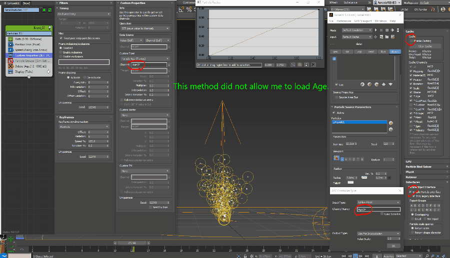

The test1.gif is a diagram that I tried using the method you presented.
The AFC is not functioning well here.

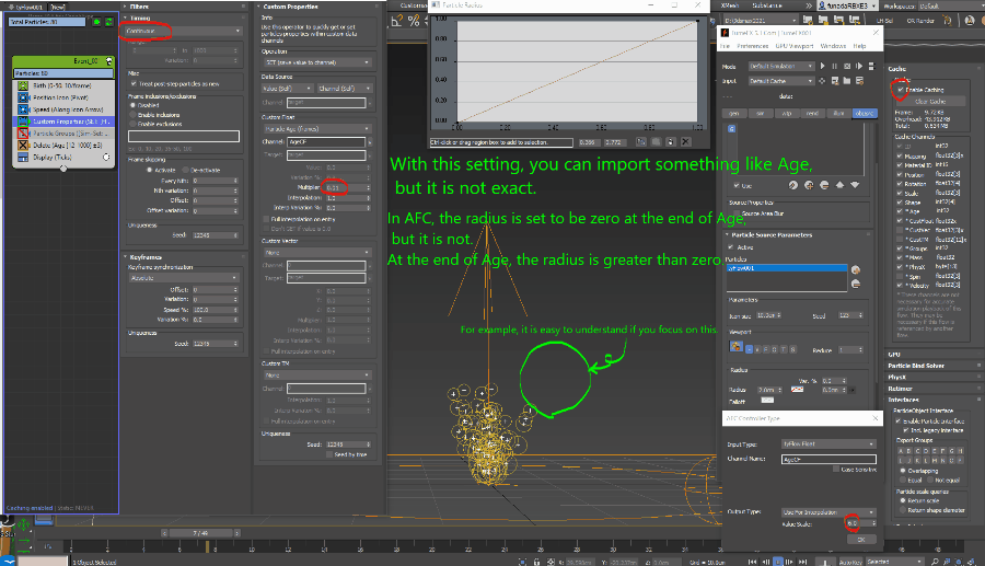

The test2.gif is the one with adjusted parameters. The adjustment details are as follows.
1. Enable Tyflow cache
2. Custom Properties >Custom Float >Multiplier set to 0.01
3. Set FFX Particle Src >AFC Controller Type >Value Scale to 6.0
However, there is also a problem in test2.
With this setteing, you can import something like Age, but it is not exact.
In AFC, the radius is set to be 0 at the end of Age, but it is not. At the end of Age, the radius is greater than 0.
The ideal_image.gif was created by loading Particle Spray and setting the AFC, but the AFC works correctly here. (The radius is set to 0 at the End of Age.)
