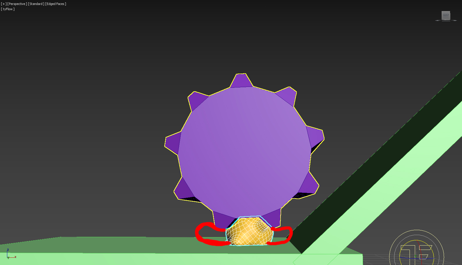

i want to make a softbody balloonstyle sim like in the my clip.
But if the cloth object is squeezed it dosent inflate like a real balloon would do.
How can i setup the sim to get ballonstyle behavior?
.mp4   test1_Perspective_preview_v002.mp4 (Size: 3.51 MB / Downloads: 246)
Firstly, if you have bend stiffness in your cloth enabled, disable that completely (set to 0). Then drop all the other stretch/shear stiffnesses down and decrease your sim timestep. You may need to greatly increase the inflation value too.
Thanks, it looks better now!
