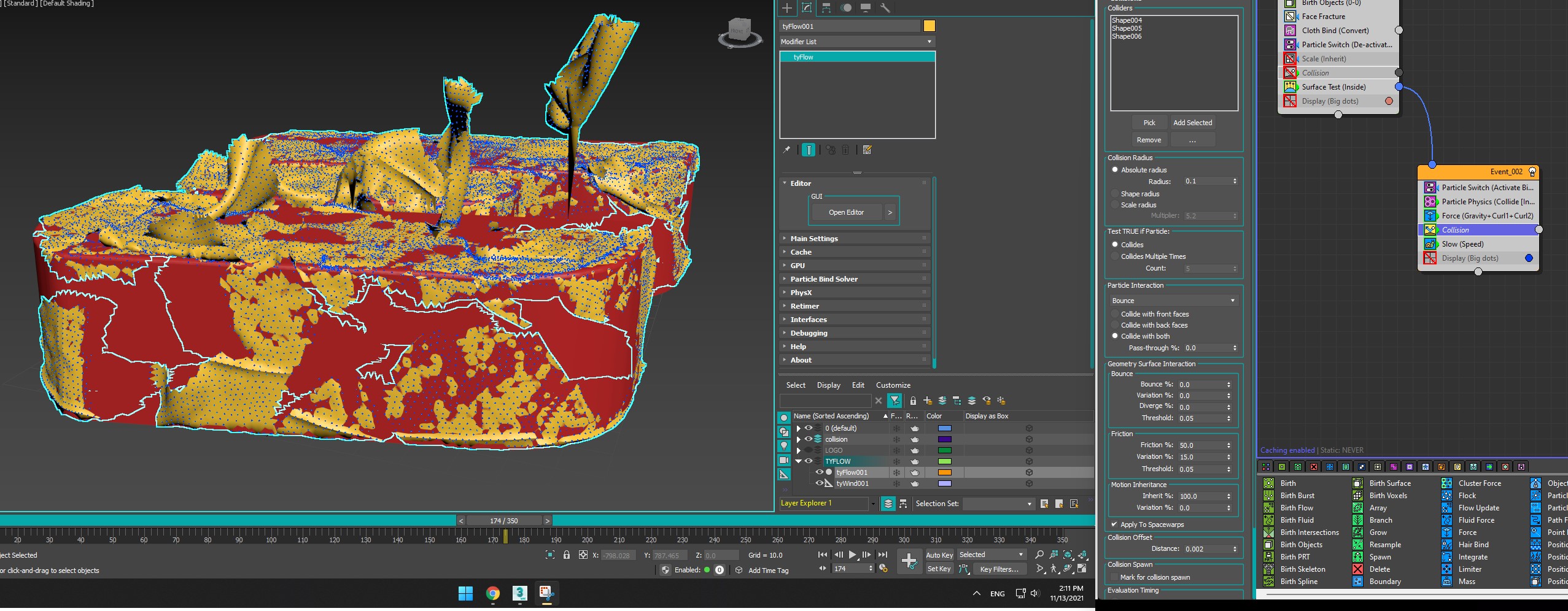

I don't know this is a bug or not.
Pieces of fabric stick to the collision object.
.max   collision.max (Size: 9.54 MB / Downloads: 429)
If you're not using the CCCS, you could try switching interaction mode to "collide with front faces"...then particles won't get stuck on back faces.
