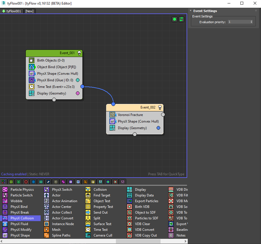

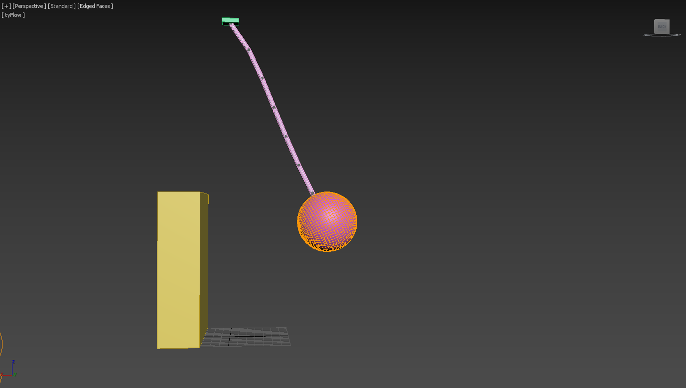

I'm start on tyflow and I have a little problem: I'm trying to make a wrecking ball with a simple rope. I did a little simulation with massFx and it's ok. And I wish the wrecking ball would shatter (not the "collider"!!). I must surely do it very, very badly, I tested a lot of things but I do not know how to combine a massFx simulation and a destruction with Tyflow ... and I am not sure that this is the right method as well. ... Can someone help me? Thanks a lot.

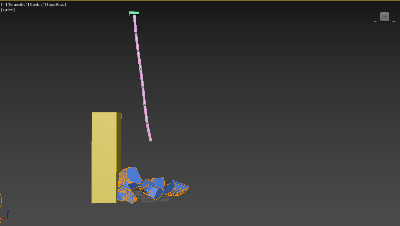

Tried to help... hope its close...    (Maybe some particleskin on the rope geometry or something)
.max   ballwall.max (Size: 704 KB / Downloads: 367)
Whaou very nice Espen, thanks you a lot!!!
