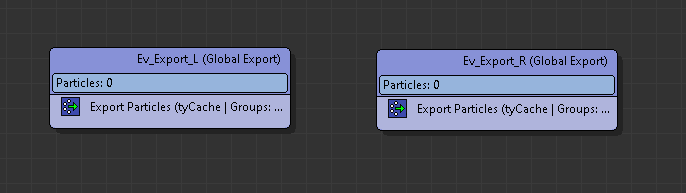

please tell me, how to access each operator has the tyflow via maxscript.
example, the tyflow has two events 'Export_Left' and 'Export_Right', it has 'Export_Particles' operator.
--export script code
ty.Ev_Export.Export_Particles.tycacheFilename = @"C:\tyCache\export_.tyc"
ty.Ev_Export.Export_Particles.exportTyCache()
it's go well.
but the problem is on some exports.
I do't know how to access each operator has the tyflow.
the script needs each operator name in this code,
thus i want to each them automatically, instead of hard-coding.
thanks
