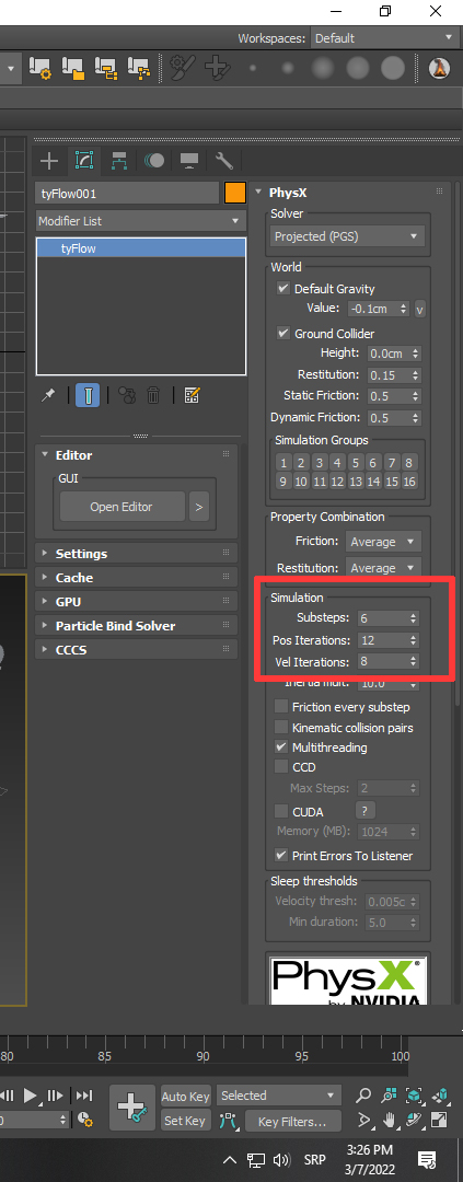

There is also 3 options under PhysX (also on Tyflow icon), that you can increase for better accuracy.

Which 3 other options can we adjust for better accuracy?
        This one.
OK we have tried to adjust all of these operators. sadly there are still some particles which fly through.
