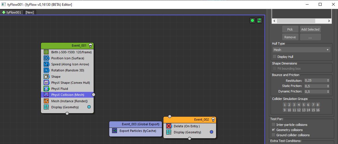

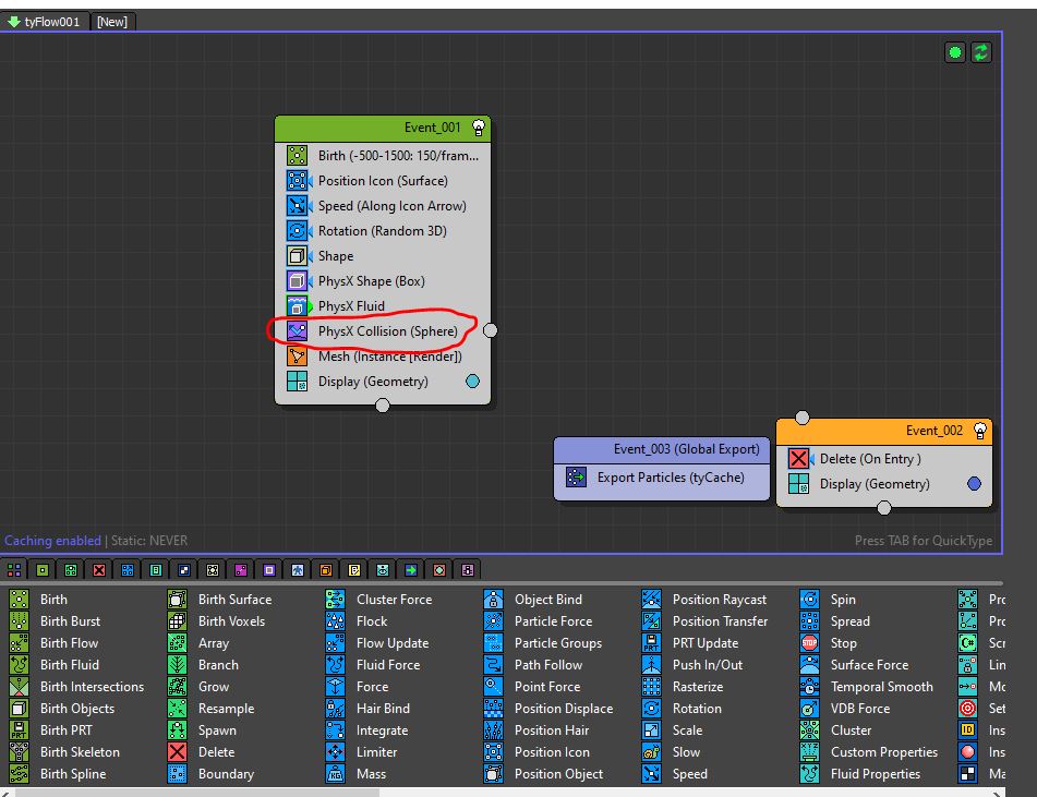

I wonder why there seems to be a ground collider in my simulation. The ground collider has been disabled.
I'm using beta. I have purchased the Proversion and I will install it when I get new workstation to avoid license transferring issues.
Hello,
You need to disable groundcollision in the physx rollout in the tyflow object:
Yes, the default PhysX ground and gravity is an idea borrowed from PFlow. Sometimes it's handy, sometimes...not Smile As tim showed, easy to disable.
As for PRO, remember that license migration is pretty easy so no need to wait for your new workstation if you want to start using your license. If you run into transfer issues when you get your new machine (let's say you get rid of your old machine and forget to deactivate first), no problem, just email support@tyflow.com if that happens and I'll get you sorted out. Please feel free to start using your license today!
Thanks very much, it was simple and worked.

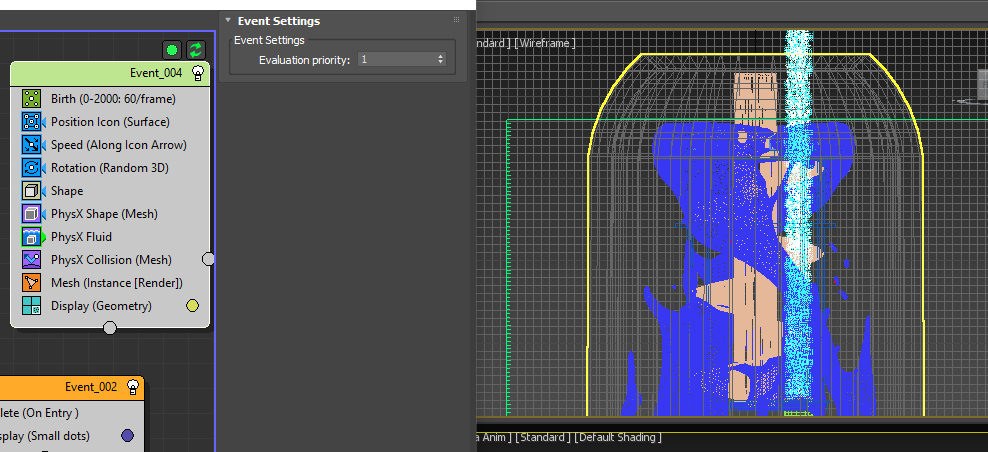

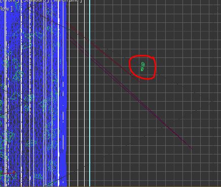

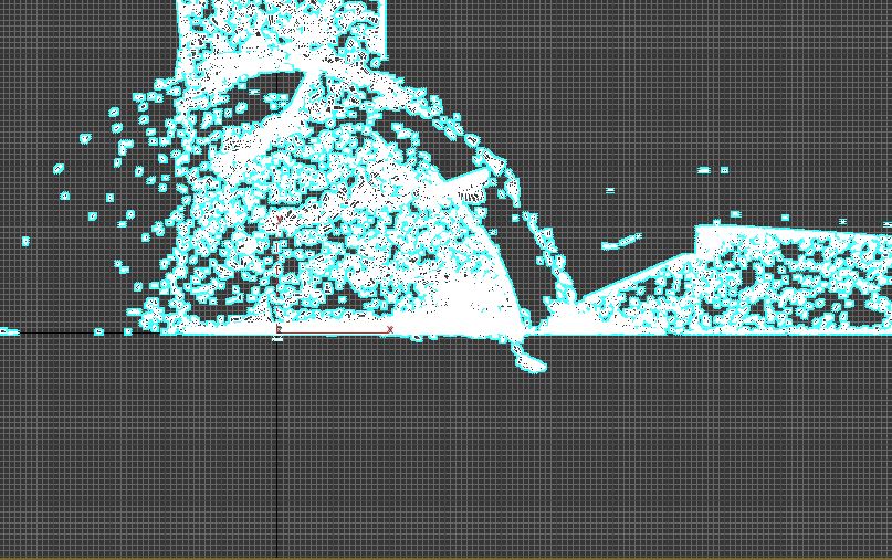

Anyway, I have another issue with this scene since the beginning. I have this chute filled with liquid. The liquid comes from left and particles from top. I have used the same collision object for liquid and particles. It seems to be watertight with liquid, but leaking some particles. The leak occurs on the region where the fluid hits the wall on the right side. There are other particle leaks elsewhere. Is there anything, I should try to stop the leaking?

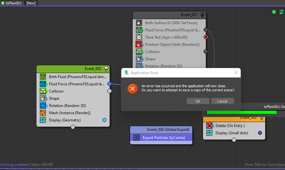

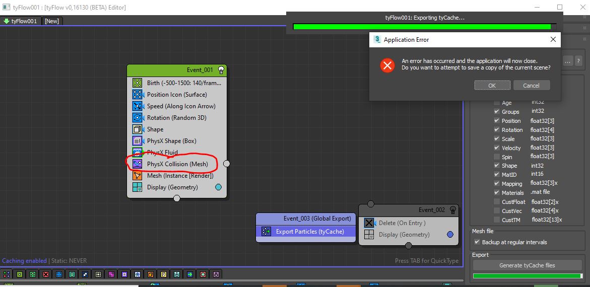

I also ran into interesting issue. Max crashes during exporting particles into tyCache. When saving the scene on crash window, the new scene has changed collision geometry mode from mesh to sphere. Any ideas?
If it’s crashing, please submit the minidump.
Please find attached the Minidump file.
.dmp   3dsmax_minidump.dmp (Size: 5.81 MB / Downloads: 276)
Hmm, looks like a memory issue but you're also running a fairly old build. Could you post the file (or send to support@tyflow.com) so I can take a look directly? How much RAM does your system have?

Ah, with other heavy sims could be purely a RAM limitation then. Try exporting on your laptop with flow caching disabled.
#11
I managed to adjust the simulation in way, that it doesn't crash anymore with laptop. Anyway my point in my previous posting was, that for some reason the Collision objects had changed from mesh mode to sphere mode in crash back up. I didn't know if it was changed during simulation or during crash.

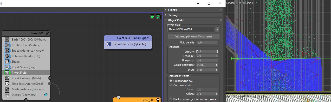

Anyway here's another. The simulation seems to be throwing particles up from liquid. I would expect them to slow down, when hitting liquid and still continue moving downwards. Is it in my PhysX liquid settings or PhysX shape settings.
#12

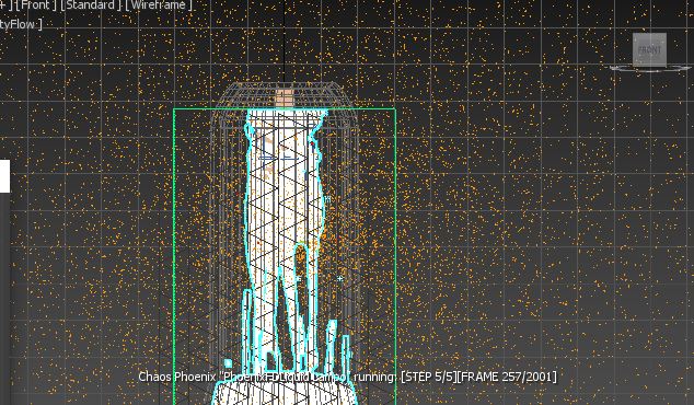

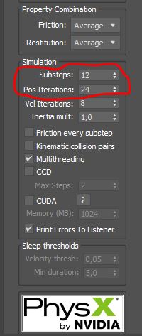

I'm getting some progress, but I'm still struggling with particles flying through the collision objects. I guess, they get extreme speeds driven by the Phoenix liquid simulation. What would be the tyFlow operator to look at?
#13
Decrease the Timestep value, to 1/4 or less in Tyflow icon.

In the meanwhile I ran a simulation with modified PhysX values. I doubled both substeps and Pos Iteration values. It was much better. Next I will test Your suggestion.
When using PFlow with Phys X, the ideal substep value was 3. The bigger the value, more unexpected results I got. In tyFlow it seems to be different.

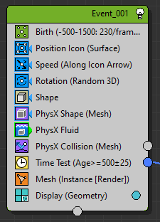

[attachment=2200]I wonder what is the main difference between PhysX and non PhysX operators when simulating particles in fluid? PhysX setup is working fine when particles come from separate source, but do not work at all when the system is initially filled. On the latter case, they don't stay inside the liquid. So, I wonder if I should have additional operator to define the buoyancy. On ideal case particles should be floating for a while before getting wet and then they start to travel towards the bottom outlet of the system.
My question is, what non PhysX operator would be suitable for buoyancy in such scenario?
