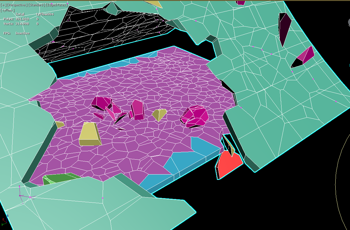

Quick question - would I have to export the roof fractures to an animated mesh so that i can use them as collisions for the house's ceiling (right below the roof)? I'm using the same bind-search setup as the roof.
As you can see only the outskirts of the ceiling is highlighted blue by the surface test which tests for distance between ceiling and roof models. I'd need it to test for distance between the moving roof fractures only and the ceiling :
Edit: the ceiling/floor doesnt seem to work with bind search the same way as the roof does, as you can see there are still blue fractures floating in the air

Well the effect you're going for is "simple", but it takes some understanding of key concepts to get it working. For example, having a floating roof behave in a physically plausible way requires understanding of the difference between kinematic/dynamic bodies, bindings (constraints), collision events and triggers, etc. Complexity can easily spiral out of control as you add more and more conditions to the simulation, especially if you're still learning what all of these concepts mean and entail.
As for disabling collisions after a certain frame, you could send the particles to an event that doesn't contain that PhysX Collision operator (or trigger the explosion with a force, rather than a collider). Unlike the regular Collision operator, PhysX Collision works a bit different so it doesn't have the usual timing/filter rollouts.
As for alternative systems, you could certainly try Thinking Particles...but you'll have to wrangle all the same concepts, just using a different workflow.
#11
Thank you, that really helps - I also want to let you know all the issues was due to my scene scale. It's in meters, have tried exporting the roof and ceiling into a centimeters scene where it works wonders and the binds does what they're supposed to. This has been a very frustrating week but I'm happy to know why it kept calculating things entirely wrong.
