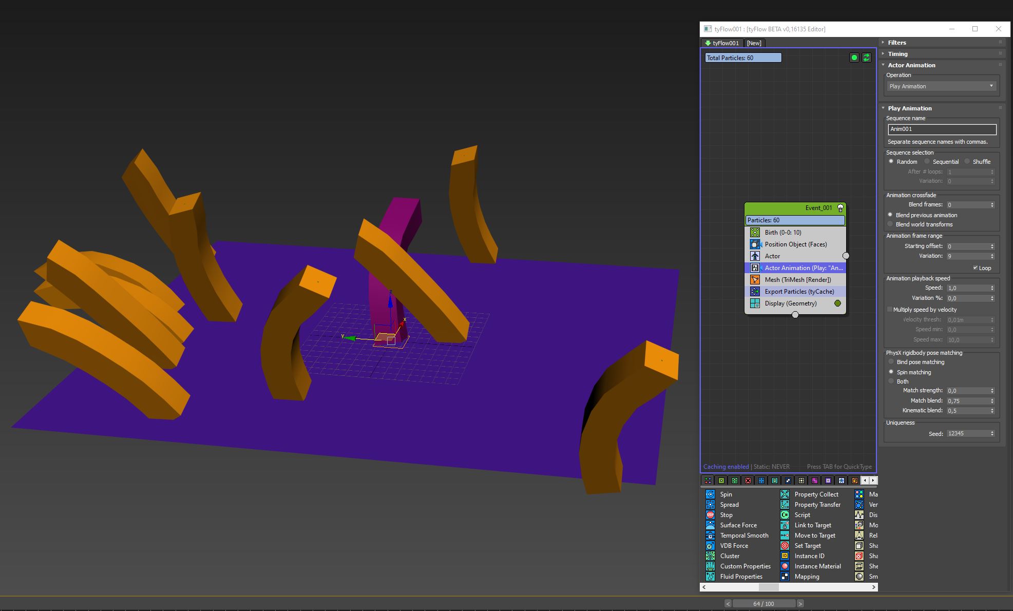

Hello everyone,
I made a simple scene with a box wich is skinned to 4 bones.
I added that box in an actor with animation sequence checked like in the picture.
My actor is spawned on a plane and is well animated like you see.
I added a mesh operator (not sure if necessary)
Then an export particle operator. I try to export a tycache.

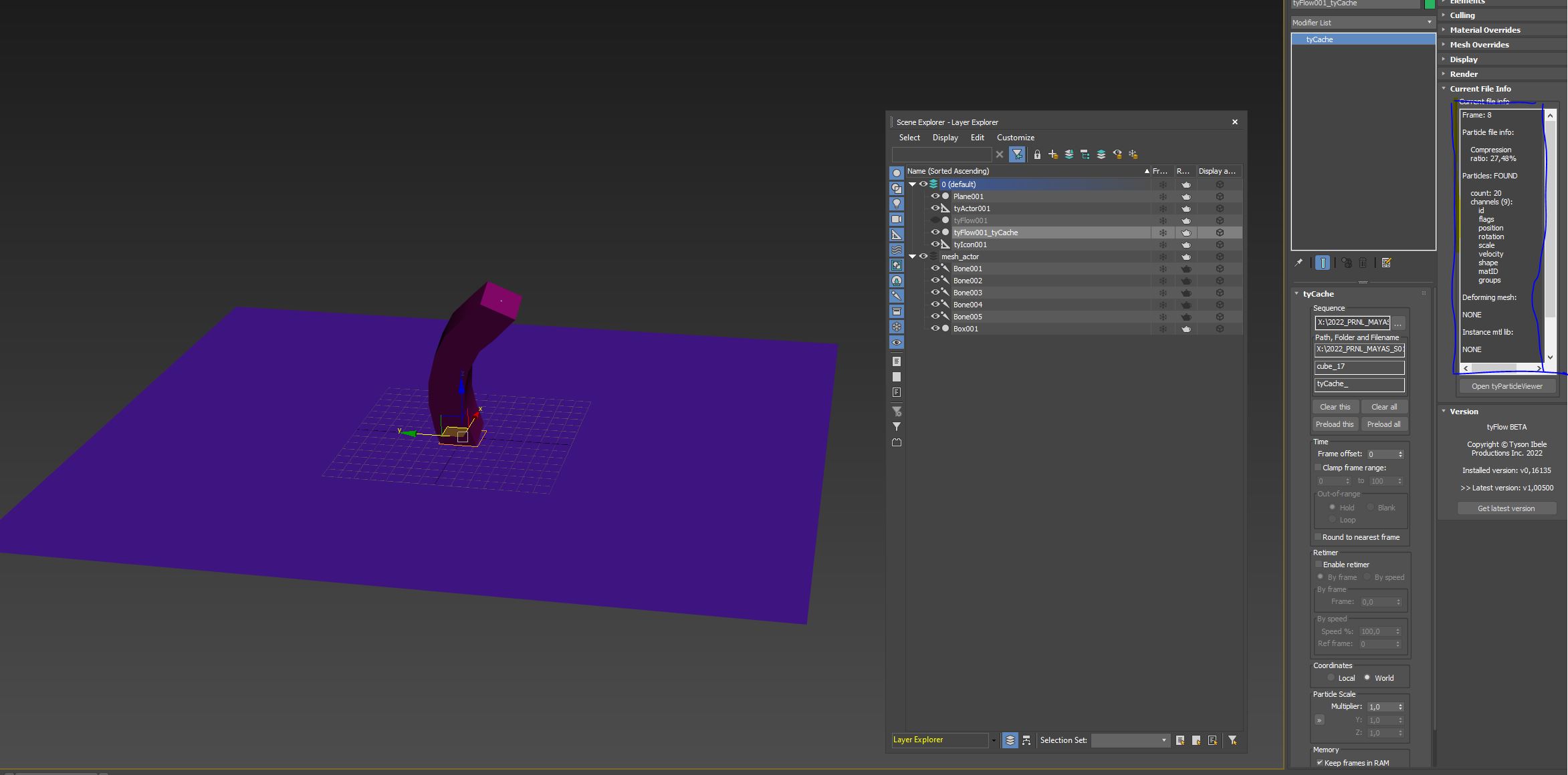

When imported automatically at the end of export simulation, I hide the original tyflow. My tycache show nothing
In current file info I can see there are informations (bordered in blue on the screen).
Would you know how to do the right way in it's not ?
Maybe actors are not permitted to be exported in tycache ?
In alembic or vray proxy it works but I would prefer tycache for the sake of small size file and keeping my multi materials.
Thank you !
Clément
