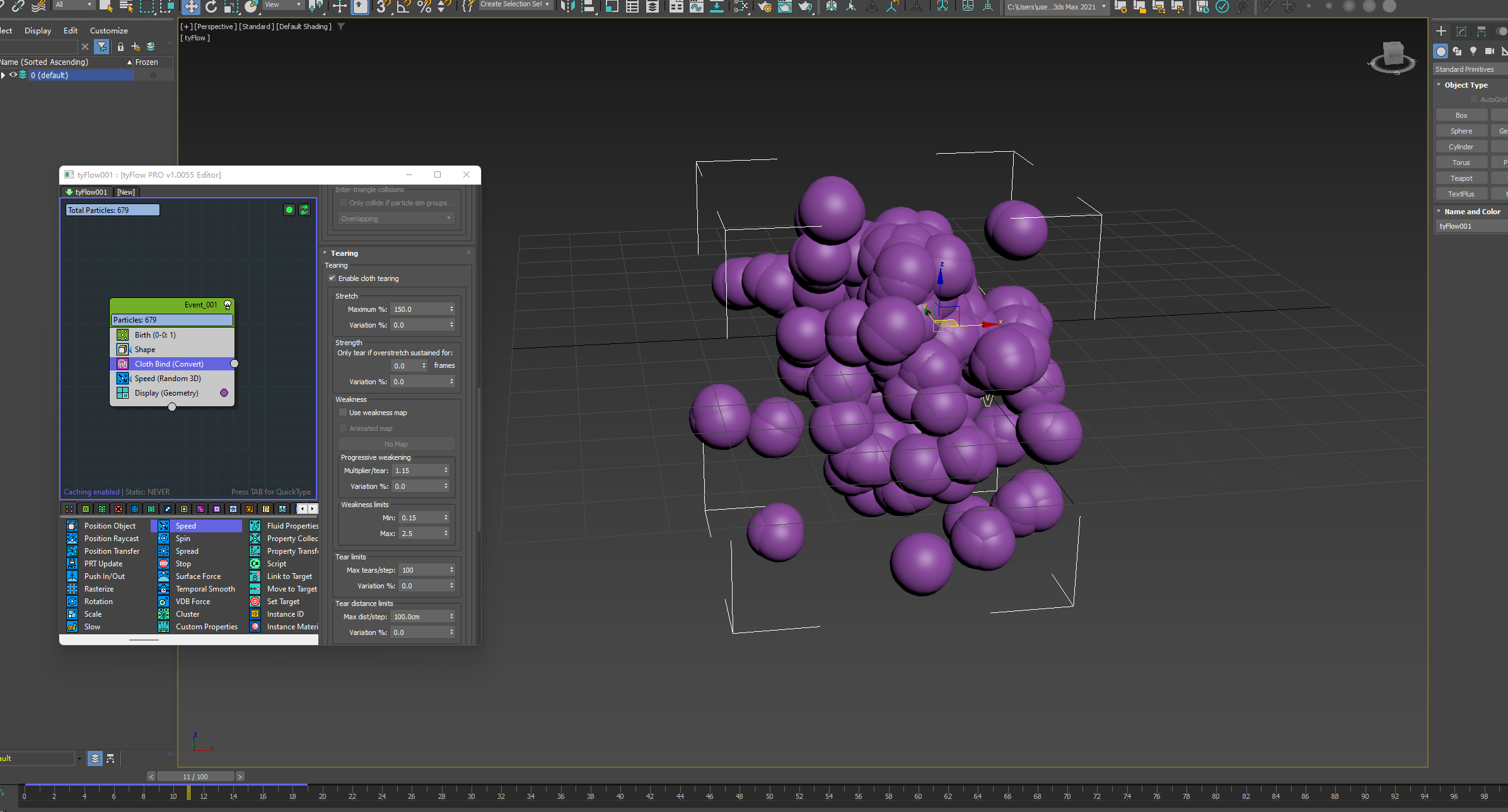

HI,Tyson!
I convert a small ball into cloth, and then activate cloth crushing, so I get so many small balls. Very strange.
Can you post the scene please?
ok,this is file
.max   tyflow_cloth to sphere.max (Size: 704 KB / Downloads: 284)
You can add a Shape Remove operator to remove the shapes. What's happening is that when the tears occur, new particles are generated...and those new particles are inheriting the shape information from the original parent particle that was converted into cloth...this is obviously not good behavior (I will fix in the next build), but the workaround is easy (Shape Remove).
okay, thank you
