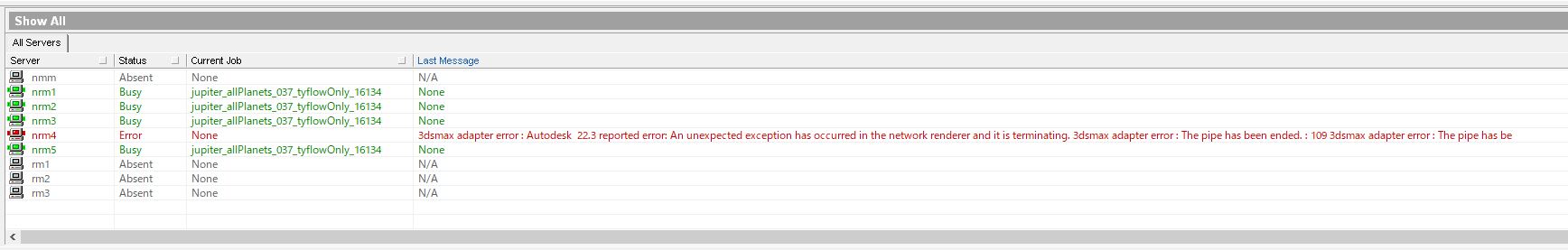

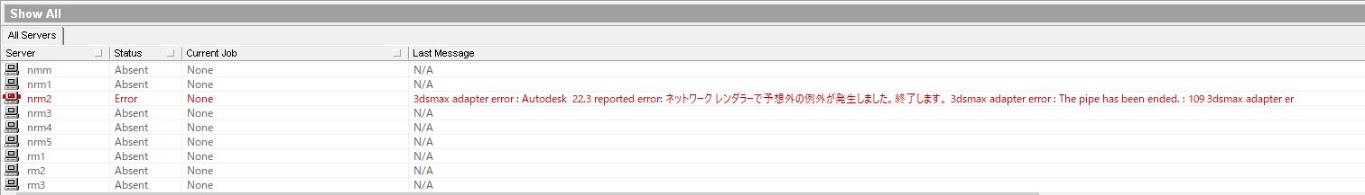

It's actually the same data you helped me with the other day (collision spawning) and I'm having problems net rendering a file that renders fine locally. Backburner was throwing me the attached "109" error , but that seems to be absent when I isolate the tyFlow system from the rest of the data. It renders, but the "clefs" disappear on certain frames. I've attached the data. The clef is absent from the render in frames 297, 319 and 341. Also, the starting position of the tySpline is different from local render - the lines originate at the dummy pivots on local render, but lag behind on a net render.

I installed 16134 and tried ExportParticles with tyCache (splines). It fixed the splines problem, and I thought I was home and dry, but from frame 600 of the animation, I started to get the attached 109 error again. Could it be hitting some kind of memory limit? Is there a setting I could try?
