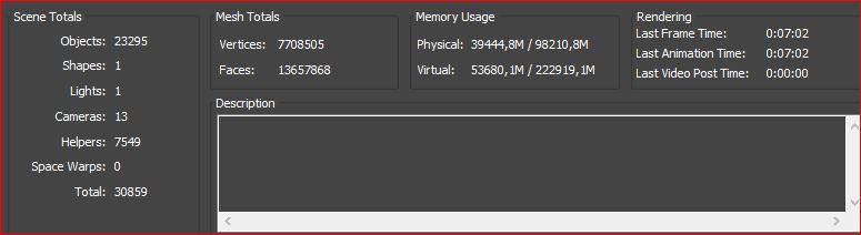

Now I'll start with the project geometry. The scene consists of thousands of objects. Do You recommend collapsing those with booleans to smaller amount or just add them all into tyMesher at once?
I tested with 1 of 8 013 mesh objects in scene. Max crashed with out of memory message when extracting mesh. I have only 96 GB of RAM. I wonder what would be sufficient.
Hard to say without knowing what kind of objects you're meshing. If it's 8000 spaceships, then yea you might be out of luck with out an incredibly amount of RAM. If it's 8000 cubes, then it sounds like a different issue.
I got some supplementing geometry to my model. There's now 23 295 mesh objects in the scene. When I got everything, I will collapse the model into one object and then try this workflow again.
