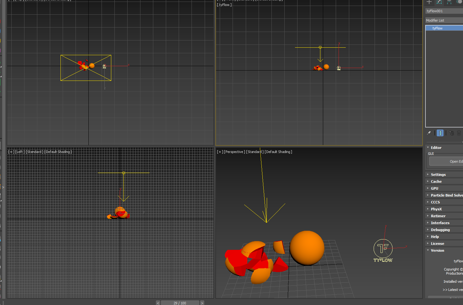

However the scene you included isn't what you probably wanted to send. see image.
If you still got the scene, please re-send, as its always interesting to see how other ppl solve issues. Thanks Smile
[Image: attachment.php?aid=2375]
LOL
Sorry about that. ..
Attaching again...
.max   PhysX_Switch.max (Size: 676 KB / Downloads: 485)
