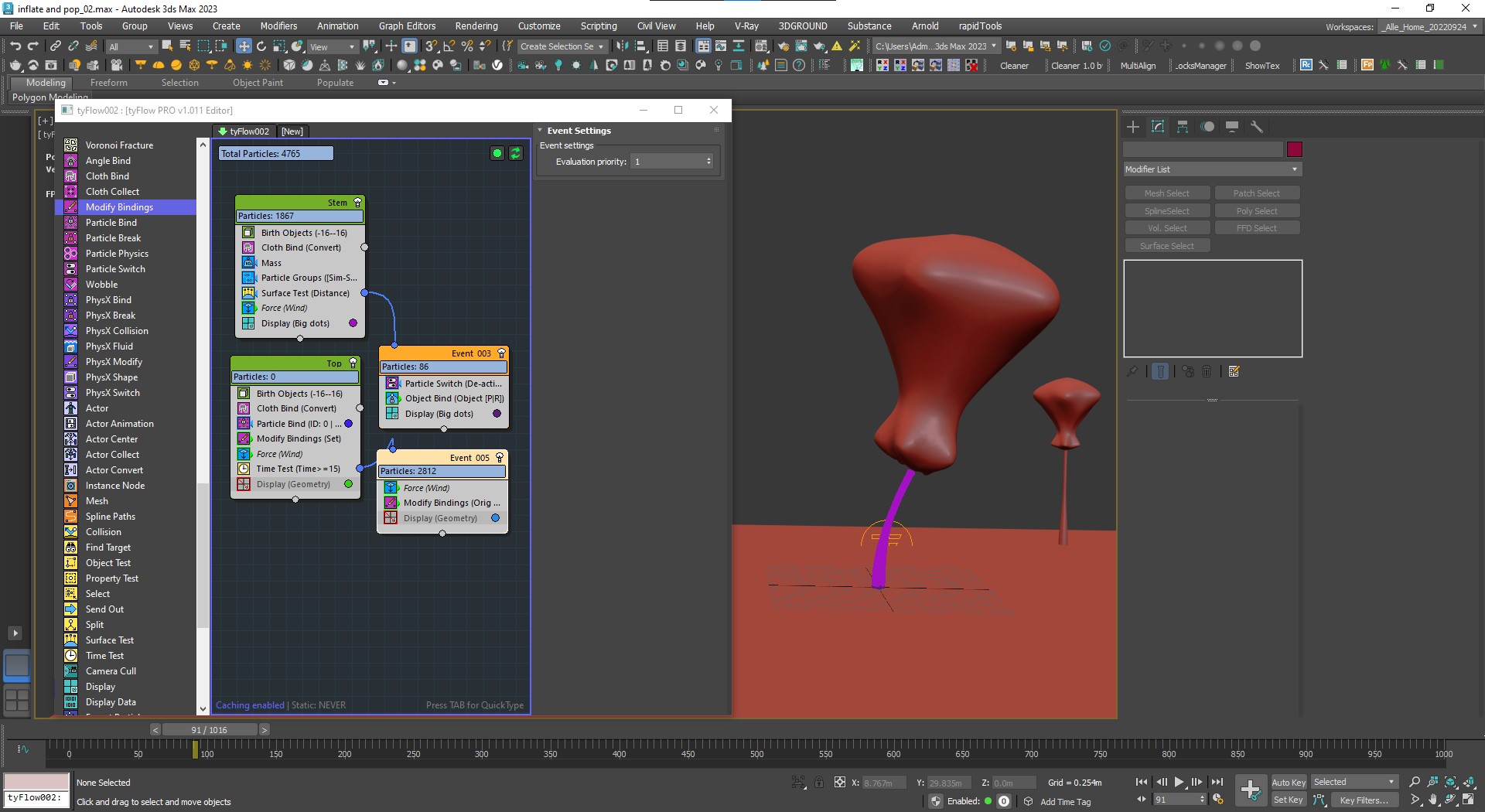

I Attach You a file and some screenshot of a quick test that i've done. The Pop part is missing cause i do not have time now to finish the test.
Later I will try to do it.
I've also simplified a bit the geometry cause is too heavy for my workstation
Hope that this can help you. I'm pretty Noob so maybe is not the thing that you need, or the right way to do it. but I've tried.
