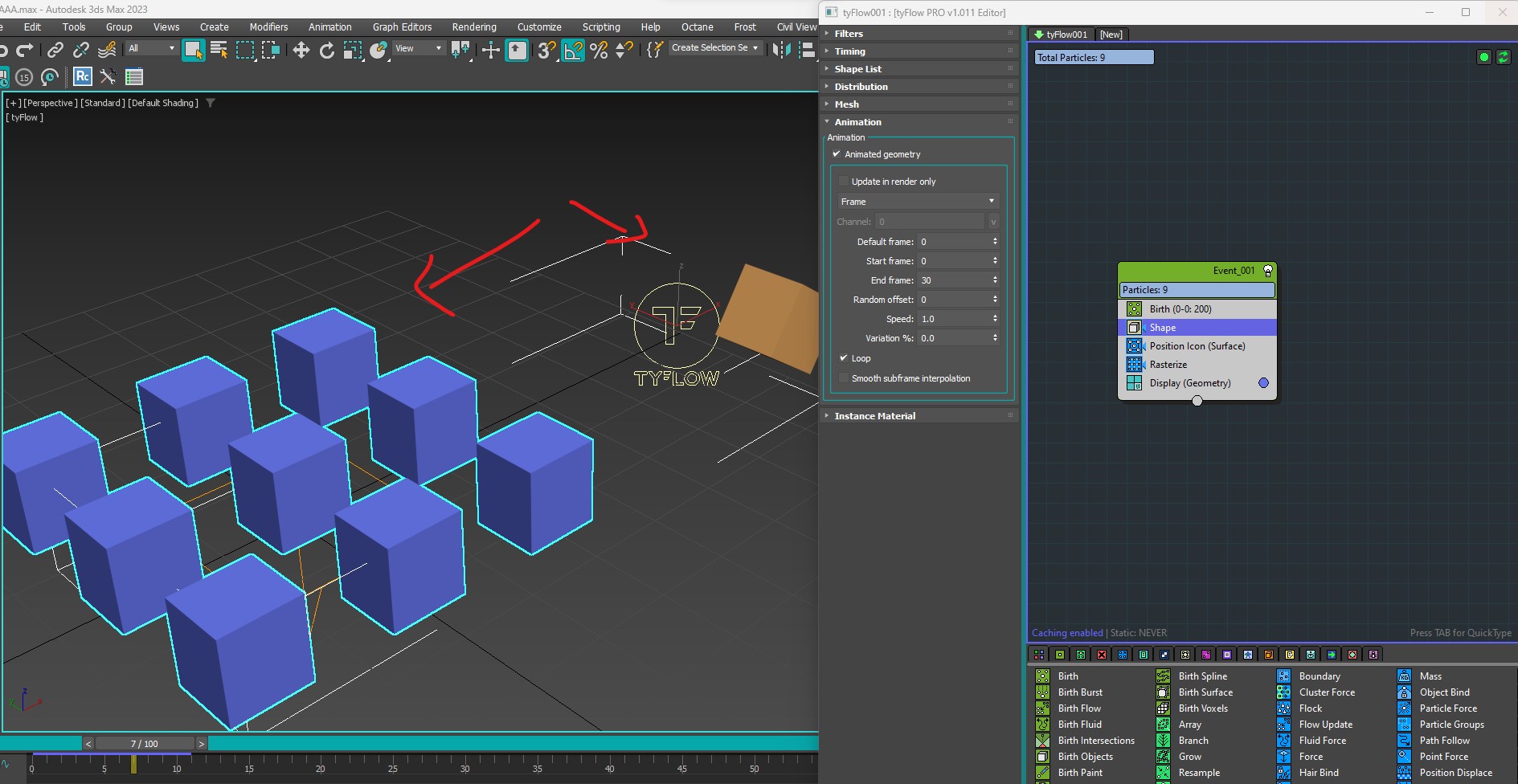

ِhow can I use object animation as a Particle?
Apparently, animation geometry in the animation rollout does not work or I don't know how.
.max   AAA.max (Size: 720 KB / Downloads: 441)
The animation settings in the Shape operator pertain to deformation animation, not keyframes on the position/rotation/scale of the object.
However, if you select your animated object and group it (to itself), then add the group head as the reference node, the transform animation should come through.

(11-22-2022, 04:23 AM)tyFlow Wrote: The animation settings in the Shape operator pertain to deformation animation, not keyframes on the position/rotation/scale of the object.
yes, thank you
