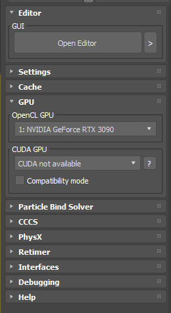

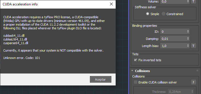

[b]I recently bought the Tyflow PRO version. I installed Tyflow and the CUDA dlls to the plugins folder of MAX 2023 and updated my 3090 Drivers to the latest version but CUDA it's not enabled (I tried on a different computer and it works ok). On the Tyflow Icon GPU menu i get CUDA GPU: CUDA not available message and if I click on the ? MAX crashes. If I create a Cloth Bind and check the question mark I get the error Code 101. I also tried to install CUDA development Kit but nothing worked.
Any help will be appreciated.[/b]
I managed to solve the problem by resetting the MAX UI to default settings. The Question Mark on Tyflow Icon CUDA GPU stills crashes MAX but the CUDA collisions are working. Sorry for the inconvenience. I don't know if this will be of help for future users otherwise, let me know and I will remove the post.
That's very strange to hear that Max is crashing when you press that button....
Can you post the minidump? (instructions are in the sticky post)
Ah, I've found the source of the bug. Will be fixed in the next build.
