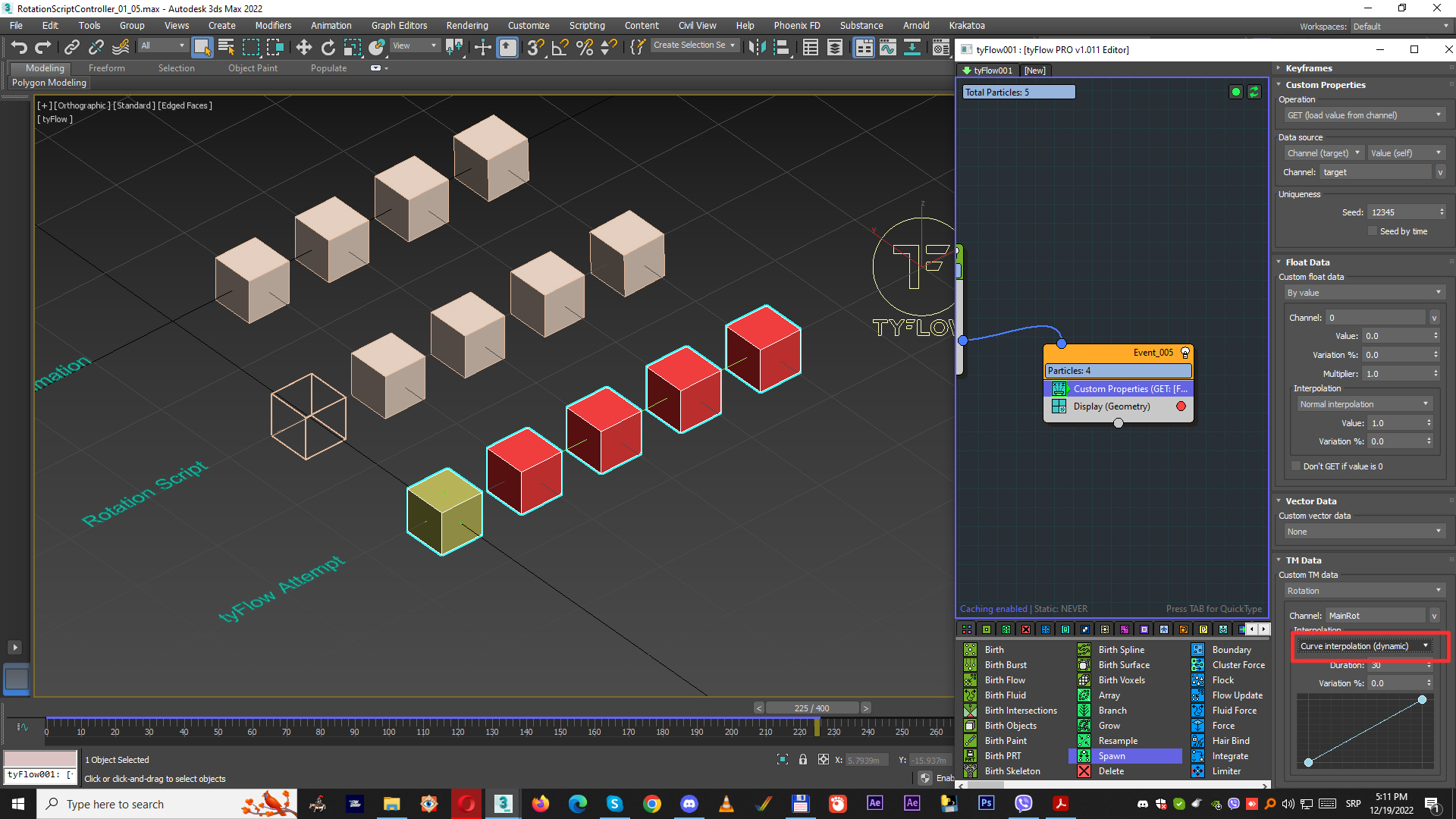

Try changing  interpolation to this
Uhmm if i do that in my computer (max2022, tyflow v1.011) i get the opposite effect of what im trying to achieve x)
Now (with curve interpolation)  they take 30Frames to align to the absolute rotation in the customTM. And to achieve that they get this easing applied. I cant use that too sorry.
I want them to keep the animation length and speed, just offset the starting frame.
