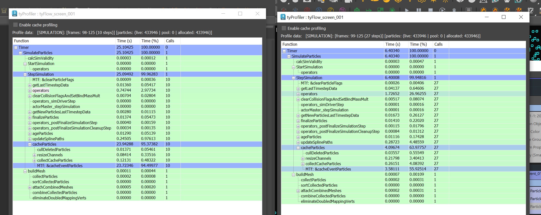

I did a fast test but is inconclusive I get lots of mixed performances now... sometimes fast some times slower then fast again.
MTF: &cacheEventParticles  seems the one that changes the most as for now...
I will wait until I get a clear slow down and try again tomorrow.
hummm clicking away from max.. coming back and resimulating and boom it choked suddently.
I tried on a new file side by side the same exact range of simulation ( ups now I checked and I'm missing one frame, but... anyways... the simulation is very stable so is not that frame.), and was 25seconds vs 6seconds.
and yes the slowest with difference MTf: &cacheEventParticles.

There's a known issue in the current build (fixed in the next build) that causes slowdowns when playing a simulation for the first time during caching. This only happens when playing a simulation frame-by-frame (ie, hitting play and waiting for it to cache)...it doesn't happen when simulating a chunk of frames (ex: snapping the timeslider to the end frame and waiting for the simulation to finish). This slowdown would indeed be happening under the caching event noted in the profiler....however, it doesn't seem to be what you were running into in your video...but it's possibly related.
Next build will be out soon....once it's out it would be a good time to test. I can't recall when this regression was introduced...you could experiment reverting back to the last beta build and see if you see the same performance degradation. If you don't then this bug is likely the cause. Grab the latest beta here: https://docs.tyflow.com/faq/beta
Actually...for low numbers of particles, the regression may affect performance even when not playing back flows frame-by-frame...so performance should be improved overall in the next build.

Not yet too much testing, but seems this got better on the latest build.
BTW super cool build! congratulations and thank you!
