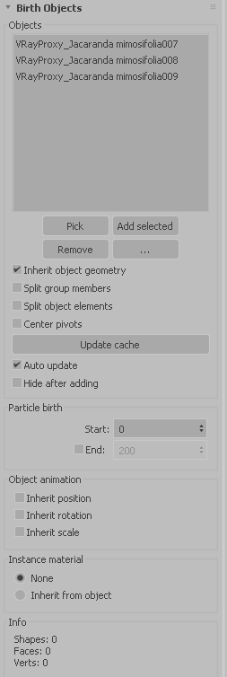

Is there a way to have an animated vray proxy as Birth Object and keep the animation.  It seems that tyflow does not see the animation or I'm missing something.
see the attached screen capture of how I have it now.
Any help appreciated.

What kind of animation? Animation on the input object's transforms? If so, enable the inherit animation objects.
If you're talking about deformations, only the Shape operator (or Actor operator) can import those types of animations.
